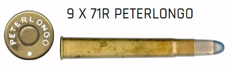

perhaps a propriety Peterlongo cartridge .... like this
or this
Posts: 12,777
Likes: 532
Posts: 12,777
Likes: 532
Indeed......
