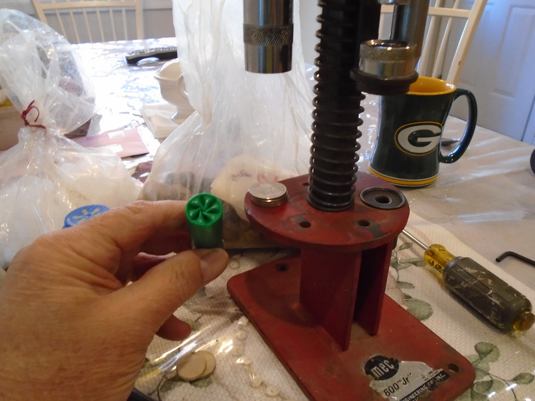

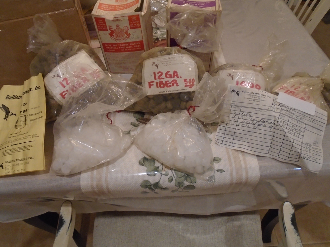

The folded crimp didn't go so well.The crimp starter and crimp had plenty of adjustment on my old Pacific 366.The hulls are a straight tube with no 6pt. memory ,so I'll be buying a roll crimper. I have 1/2" fiber wads,125"cards and bpgs wads that I bought in April,1984.I guess it's time I use them!! smile [Linked Image from i.postimg.cc] [Linked Image from i.postimg.cc]

Yes skived. I'll see how my 600jr does. [Linked Image from i.postimg.cc]

600jr to the rescue. I'll get the super crimp also. Thanks [Linked Image from i.postimg.cc]
Posts: 7,733
Likes: 698
Posts: 7,733
Likes: 698
That looks great! You are good to go.
