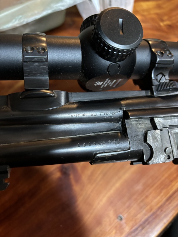

Hope someone can help with an ID on this double rifle. The name looks to be Thitiy & Liege and it’s chambered in 8x57JRS. Would like to know some info on year it was made and the maker. It’s a great shooter with the top barrel zeroed at 100 yards and the bottom barrel at 250 yards. Hope the pictures help.

Can't see the pictures without a google account. Might try something like imgur or something.

Hopefully can see them now.

With the 2900 BAR stamp, it would be later. I do not think >>I<< was used as a datecode?

The PV with the perron is Smokeless Proof for rifles (the font changed at some point).
Underlined 'I' is the lettre annale for 1994. Looks like it is oriented upside down - maybe Monday after a long weekend at the proof house bar wink

Possibly a successor to Théate Frères which ceased operations in 1965?
https://www.littlegun.be/arme%20belge/artisans%20identifies%20t%20w/a%20theate%20freres%20gb.htm
No other 'Ts' look close
https://www.littlegun.be/arme%20belge/a%20a%20artisans%20identifies%20gb.htm#T
Post a full size close up of the 'Thitiy & Liege' and any mark on the action
