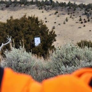

Shot a Scherping double rifle in, allegedly, 43 Mauser, for the first time this weekend. The tiny front sight blade is very hard to see nested in the fixed notch rear sight, not sure how consistent my hold was. It has one fixed blade, a flip up 200 yard blade, and a flip up tang ring, FYI. Please pardon my ghetto target, humped it up a hill and clipped it to a juniper.
**Seeking any suggestions, advice and comments.
Rounds shot on this first attempt were Buffalo Arms 43 Mauser (11/15x60R) Black Powder Ammo, 385 Grain.
Shot 3 left/right combinations.
First was at 50 yards and nothing hit the paper (!).
Second was at 30 yards.
Hits were roughly 4” high, 2” right for the right barrel, 2” left for the left barrel.
Third was at 30 yards.
Similar hit with the right barrel, left was close to the bull’s eye, but zero trust that I held correctly, could be a “flyer” in the right direction.
