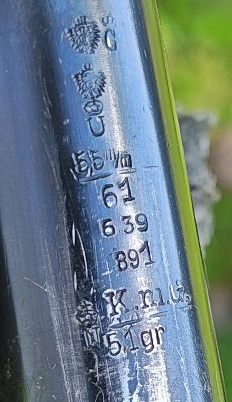

I would be more than happy to use 70 grains like everyone else, and I am curious as to just how many there are, but the stamps of this tube read >>5,1<< grammes so I would assume I a relegated to use that weight. That is unless all these stamps are adhoc and one just disregards and abandons that, then uses what everyone else is using??? And some of these bullets do weigh exactly 5,1 grammes.
I wonder why there isn't an >>Express<< Proof as the name 5,6X61R vom Hofe Super Express implies.....

Well, 3400 ft/s was easily to achieve in this morning's test w/ 44.4 grains of VV N 160 w/ a Northern Precision Bonded 79 grain bullet. I had one shot low in velocity; One @ 3200 ft/s; two that were 3425 on the nose and one that didn't register( this one may have been greater than 4k ft/s which would account for that?????). Zero signs of any pressure issues @ all but if the average continues to hover around 3400, I am officially done @ 44.4 grains. But it continues to be a Tack Driver, even with Iron Sights & trying not to shoot the Sunshades off.... It maybe, well it is the flattest shooting trajectory platform that I have ever shot. To put it into context, it is just chewing up a Evaporated Milk Can @ 30 metres with open sights. I can post a foto if there is interest..
So are y'all saying just abandon the stamps on the guns & go with what everybody is using?
