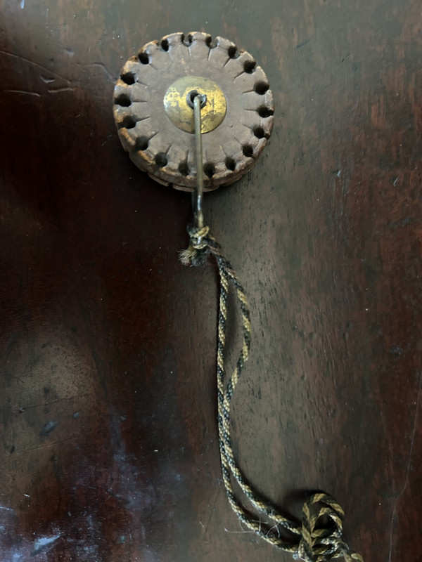

Not being familiar with muzzle loading shotguns. Can someone identify this object and it's use. It was in a case with other accessories.

Percussion cap holder, press them on the nipple and twist them out.

A very interesting cap holder, and with a design unlike anything I've ever seen before. If you look carefully you can see that it is made "two-sided", in that the reverse side appears to have a leather disc designed the same but indexed so that the caps on one side are between the caps on the other, doubling it's capacity.
I like the design.
