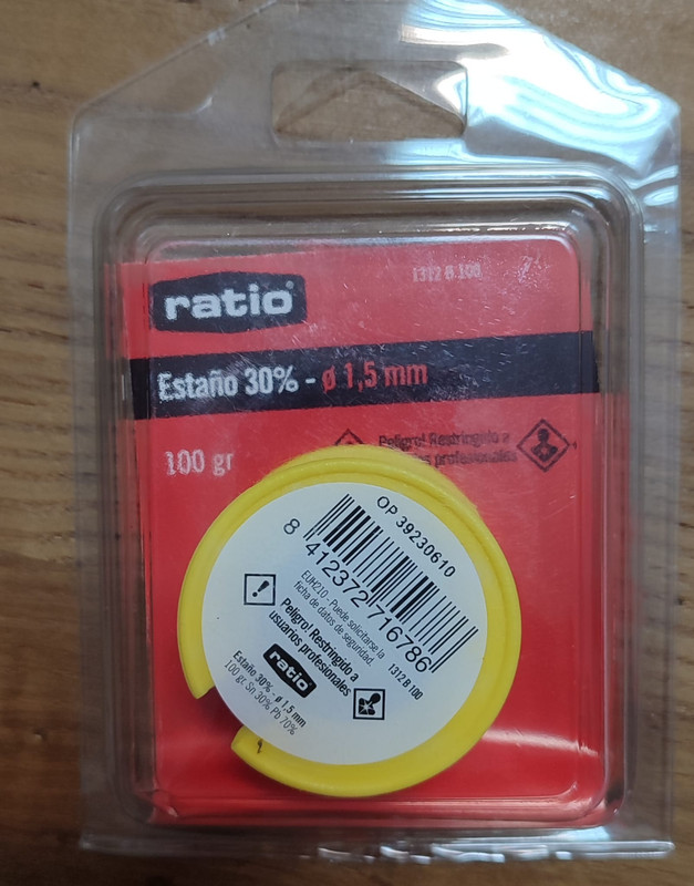

I am unable to find old 50/50% tin lead wire, but I have found and bought the following:
SN 30% Pb 70%, I suppose SN is tin, and of course PB is lead

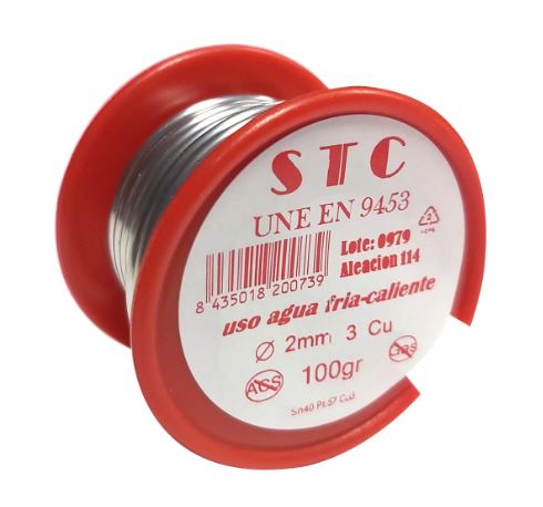

and SN 97% , 3% Cu, Cu is for copper

Can someone tell me if any of the above solders I have found are suitable??

I have found that solder that melts at a higher temperature does not work well with rosin flux. You certainly can use an acid flux and the neutralize it before joining with rosin, I do not do it that way, I use rosin flux for the whole operation. The key with rosin is to not get it too hot, once it burns you have a problem. I would look for 50/50 myself before attempting to join the ribs, my fear being that the solder you have on hand will become wet at a temp above which the rosin will burn. Of course, you could try on a piece of scrap and see if the combo you have will work. I hope that helps.

Sn is tin.
The 30/70 tin/lead solder works fine in my experience.
I used it a few times as I didn't have any 50/50 around.
It melts at 361°F , Working temp - 491°(flow temp?) according to a couple sources that sell the stuff.
Looks like it was a favorite dent filler in the days of repairing sheet metal like car fender dents.
Rosin flux works with it and some of the solder offered is Rosin Core.

Rosin flux should be available in Spain. It is a natural resin extracted from pine tree stumps or bark, known as rosin or colophony. I Googled the Spanish translation for rosin, and it is "la colophonia". It consists largely of abietic acid, which acts as a cleaning agent when heated to remove oxidation. It is very commonly used as a flux for soldering electrical circuits, and a lot of electrical solder has a rosin flux core.
The 97% tin/ 3% copper solder you bought is intended as a lead free substitute for copper water lines and fittings. It won't work well for relaying a shotgun rib. The Oatey No. 95 Lead Free Tinning Flux shown on the bench in one of your YouTube videos is great for tinning, as it is infused with tin particles. It works very well with regular tin/lead solders. It is corrosive, and any residue must be cleaned and neutralized.
