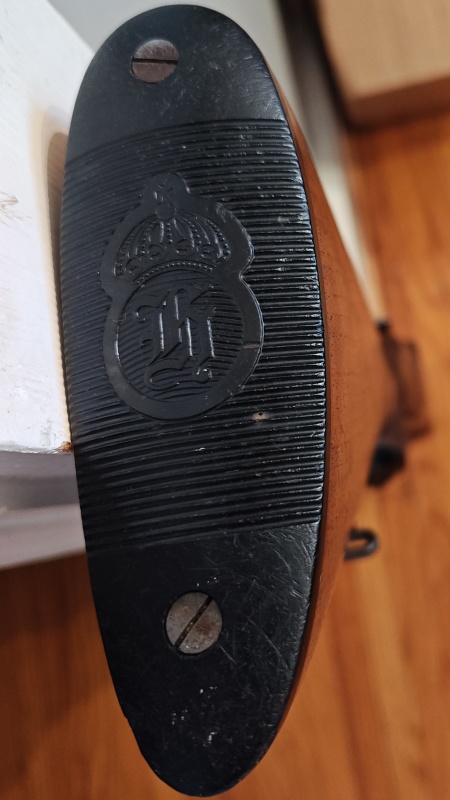

Good Eye Kutter, excellent notice......
Crown on the Underside of the Trigger, else the metal is devoid of any marks I can see.
I typically do not cotton to Chicken Scratching w/ an electronic engraver, but this bit of graffiti speaks volumes, if correct: Modell 46B(more than likely a Modell 46A from the serial number list??).
Husqvarna Vapenfabriks AB 9.3 mm
It does have a Husky Buttplate.
