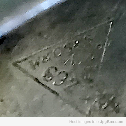

This question will be posted here because not everyone bothers with the Reilly history line. An early Reilly pin fire SN 10448 (November 1857) has been discussed on the Reilly line a couple of times. It was remade into a center-fire and a new SN added to the tang 20329 (1876) and address on the rib. The question comes from this W&CS&S 632 (W&C Scott & Sons PUN 632) stamped on the water table.
That's an early Scott PUN but what is it for? I have delved into PUN's before and there are virtually none that are consistent enough to allow for dating a gun. But as far as I am aware Birmingham was not involved at all in 1857 in making actions for pin-fires. In fact the earliest reference I can find to any Birmingham interest in the subject is the 1861 census where Breeden declared himself a center-break action maker. The PUN might have been placed on the gun when it was remanufactured.
I believe the Williams Scott firm became "W&C Scott & sons around 1858 to 1869. There is a long history of Scott on this line, probably from one of our contributors possibly from IGC.
https://www.shotgunworld.com/threads/w-c-scott-son-help-with-id-and-value.242236/
Any suggestions?

Thought about that. But Purdey (pat 1104) had predominance and up until May 1877 when the Purdey patent expired, Scott took second place and was never mentioned.
Perhaps possible if Reilly were only using the Scott Spindle part of the incestuous pairing which would explain the low number and the name. This might explain the strange long top lever as well.
https://www.doublegunshop.com/forums/ubbthreads.php?ubb=showflat&Number=665628#Post665628
Would really like to see the lumps but Holt's already has been so accommodating going back and photographing the numbers on the gun just to satisfy an academic curiosity.
Here is a cheat sheet on pertinent patents, many noted on Reilly's. Maybe "retractable firing pins?" but that was WM Scott, not W&C Scott & Sons.

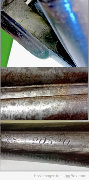

Joined: Feb 2016
Posts: 3,796
Likes: 625
Argo44 Offline OP
Joined: Feb 2016
Posts: 3,796
Likes: 625
Para, that was my original thinking. See the Reilly line for the latest received from Holt's which pretty well established it was a pinfire, appropriate text below:
I asked Holt's as time permits and for academic purposes only to try to determine where both these serial numbers are found. Holt's send the response photos below. Clearly this was an early pin-fire, 10448 being found on the water table/action flats and on the barrels. 20320 is found on the tang behind the trigger guard, no doubt added when it was converted to Center-fire. 20320 would date to 1876. 10448 would date to late 1857 only 10 numbers earlier than mine. The name/address on the rib was also changed when it was converted.
What I was trying to see is whether it had the Berringer rising bite on the action flats. . .can't see from the photo above but what little you can see of the lump seems to resemble the layout of 10456 here: Of course, it's possible elements of the action including the lumps were changed out when the gun was converted to top lever.
https://www.doublegunshop.com/forum...rd=1&Number=662796&what=showflat
A couple of posters wanted to see the lumps and barrel flats of 10456 (number December 1857) pictured above. Holts had kindly provided them.
