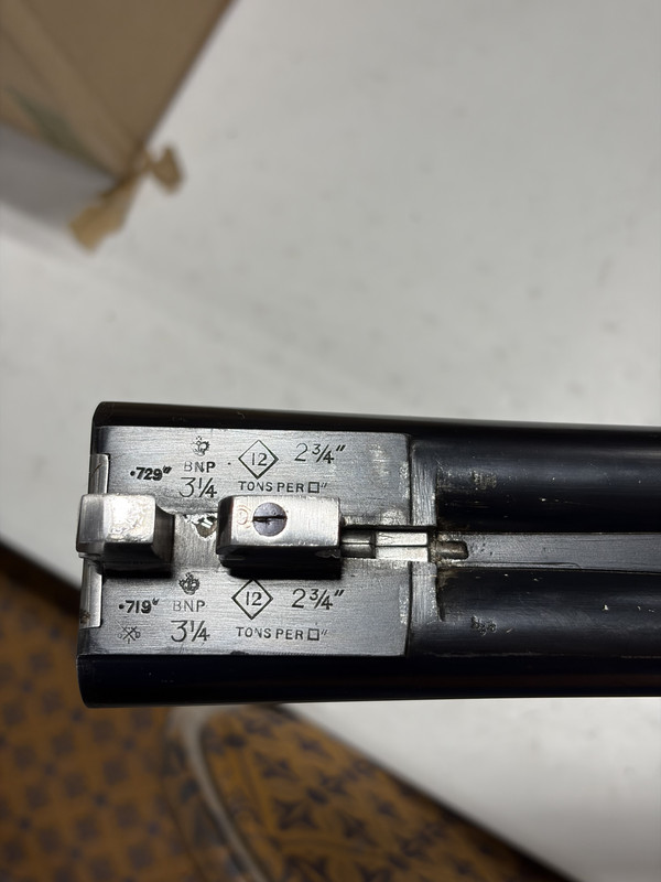

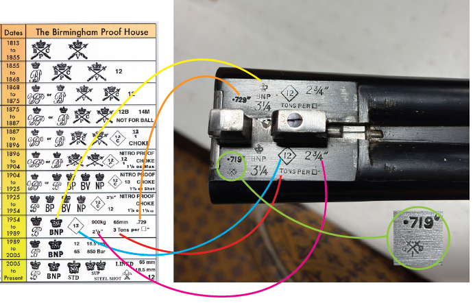

Clean, uncluttered, easy to decipher:
Which if I did this right, puts it 1954 to 1989:
...I'm being told 1955 manufacture.
...but I get 1963 from this proof date:

Drew do you have a conversion factor for British Tons to PSI? I calculated for 3-1/4 T using a factor derived from an earlier post of yours which referenced Development of proof (loads) including the US. The Calculation came out to just under 10,400 PSI.

Geoff: I agree the Birmingham date code is 'O' for 1963

...how'd I do on deciphering the proofs on the Bland?
[Linked Image from media1.tenor.com]
...trying to get better at this and looking for feedback.

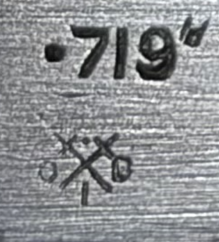

Geoff, in the enlarged photo with the .719" and halberds if the marks in the crossed halberds is "O C" then the barrels were proofed in 1988 (the letters are somewhat fuzzy in the photo).
Birmingham Date Codes
I'm pretty sure it's a O and B...but it'd be great if it were an O and a C.
I'll have to wait until it gets here to be able to look at it better.

It seems strange to have 1 barrel .729 and the other .719 but I have a theory, based on having owned several Britt boxlock waterfowlers. At the time some of these guns were made shells with felt wads were used and the gunmaker wanted to insure combustion and perhaps increase performance by having tighter constriction in the barrel.
Usually, when I see a difference in bore measurements like that, I think the worst, but, it appears this gun was proofed that way. Nice to find an English gun with 2 3/4” proofs at 3 1/4 tons.
