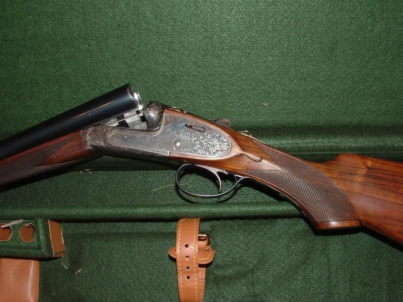

AyA Model 53 set up like a pigeon gun.
30" barrels, 3" chambers, chromed barrels, 1,200 BAR proof.15 1/4" stock over a sporting pad, 8 lbs...but fast handling.
It's a wonderful clays gun.

Geoff,
Great post and wonderful pictures of an outstanding, and ambiguous, shotgun.
The engraving suggests a model 53, but its physical characteristics suggest a model 56 (and a place at the top end of the pigeon gun range). Whatever model in may be, it's a magnificent shotgun.
