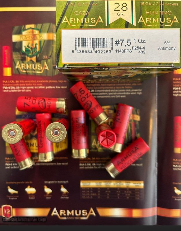

I shoot 2 3/4” loads exclusively out of my first year Winchester 1912 20 gauge. No problems to report. Short chamber, also.
Those 1375fps loads are going to beat you up in a model 97. Stock up on the pictured loads, before the law changes, and you’ll be good.
