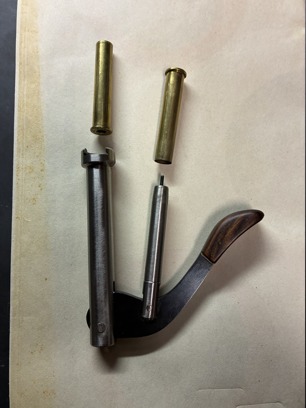

I just received my cased Rodda 577-500 self cocking double hammer gun. In the case are some reloading tools. Paper patch bullet mold, brass screw capper/decapper and a case resizer. I understand how all of them work except for the capper. The decapper part is easy. I don't understand how the capper part works. I think that the part on the bottom of the T screw is homemade. The round knob on top screws in and out but I don't see anything happening either in or out. I can't figure out how it would reprime a case. It's made by Rigby and Bartram.

How does the resizing operation work with only 180 degrees of the case contained in the die? Size and rotate 180 degrees?
Is there provisions for a removable primer ram attachment to the round knob assembly?

The capper doesn't resize. There's another tool for resizing.

Sorry, I misread your original post as the tool was one in all inclusive.
I’ll say that tool is quite a complication to achieve two simple operations!😏. I’m inclined to think there is a primer ram missing. Maybe not.
I prefer something like this.
Less complicated than even a Pope style de/re capper.

Looks pretty simple and just uses a screw for the pressure instead of a cam.

So with it set up like that tell me how to recap. If I take off the homemade brass piece at the end of the screw it leaves a large hole that the primer would then go into. These are the only other photos I can find on the net.

Looks like you have the brass in upside down? Oh, I see. You have the decapper swung in which should be out for recapping?
