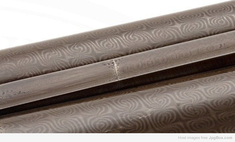

I was looking at new Steve Barnett advertisement for a Reilly for the date chart SN 32xxx (which would be 1891 or 1892). I've asked for the SN which will be on water table, barrels and fore-end. However, the ad claims it is 16 gauge "chamber sleeved." I've got a brain freeze and don't know exactly what that means. chambers are 2 3/4" obviously lengthened. the barrels appear to be intact but the rib has been cut. - portions of the address can vaguely be made out. Also trying to ascertain the address left on the rib for the chart.

Gene,
You say that “the rib has been cut” but that could well be as originally made.
It is not uncommon for that part of the “rib” to be a separate piece of steel attached when the breech ends are joined.
It is typically done with guns with doll’s head or Greener cross bolt top extensions.
You can see it below in this Greener made J. V. Needham, which has a doll’s head extension.
The rib itself is laid at a later stage to the joined barrels, and if it needs to be re-laid that can be done without the tubes themselves being separated.
