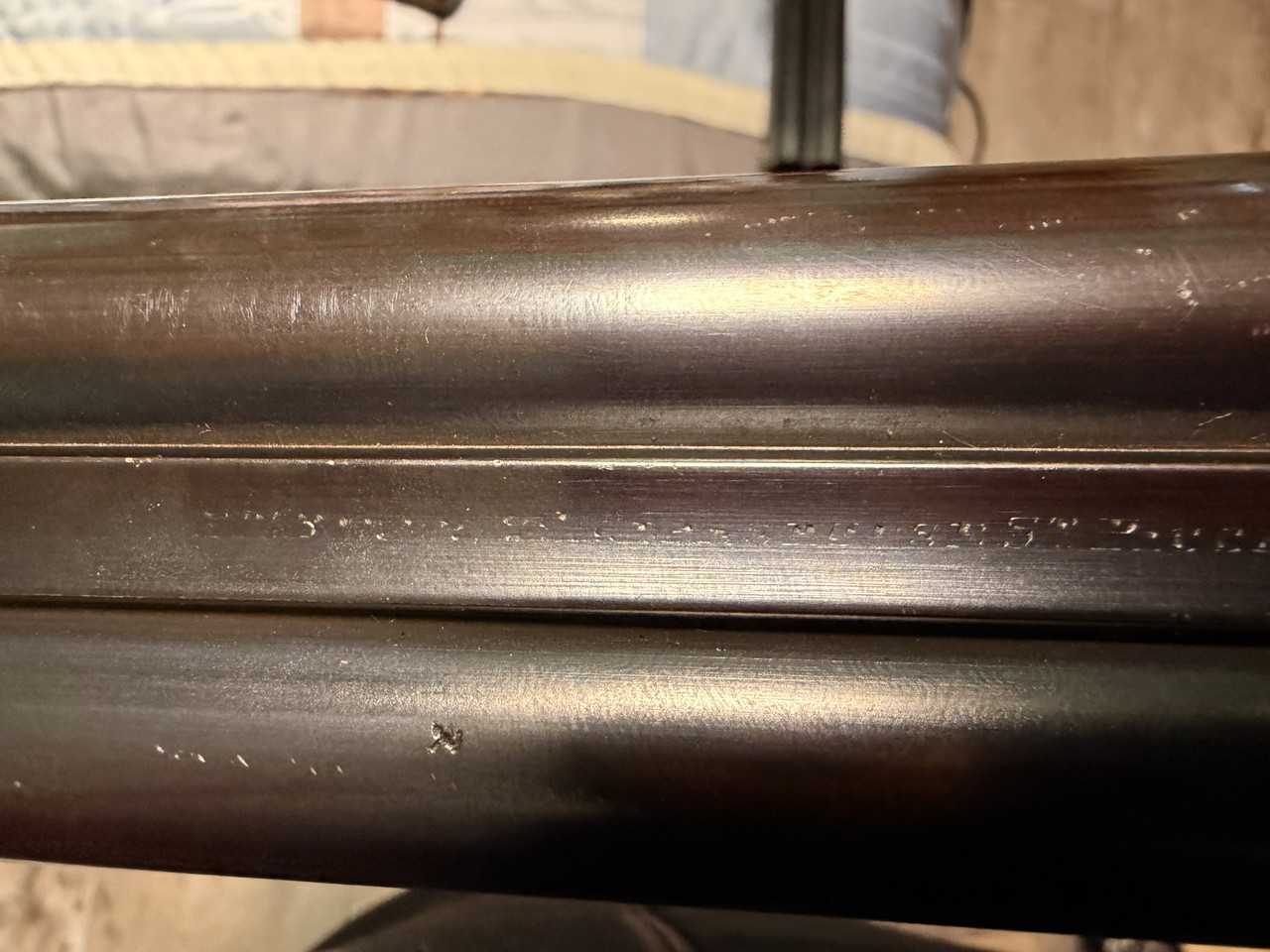

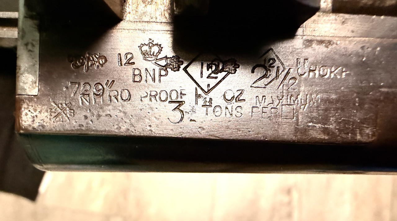

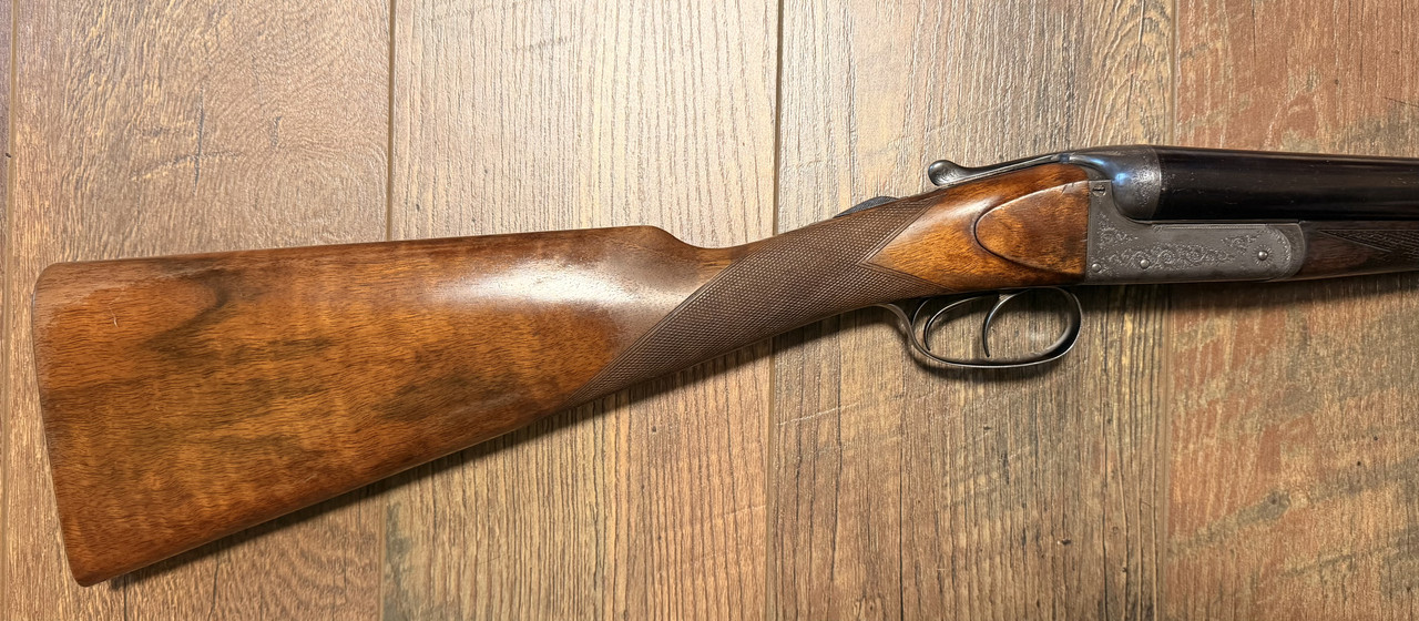

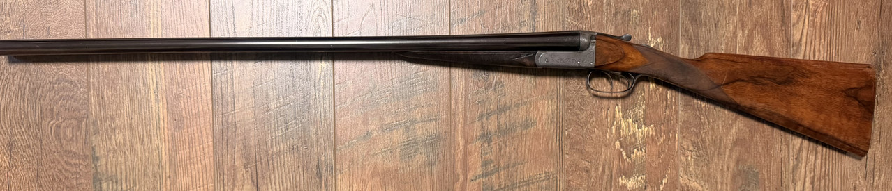

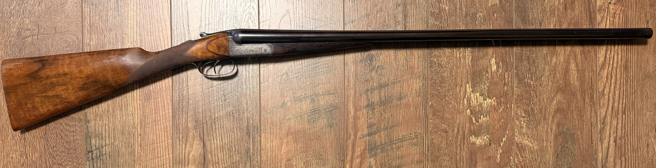

1 1/2" 12 gauge, 30" barrels, 6 1/2 lbs. CYL/CYL, 14 1/2", 1 3/8", 2 1/8", a little cast off.
Very shootable.

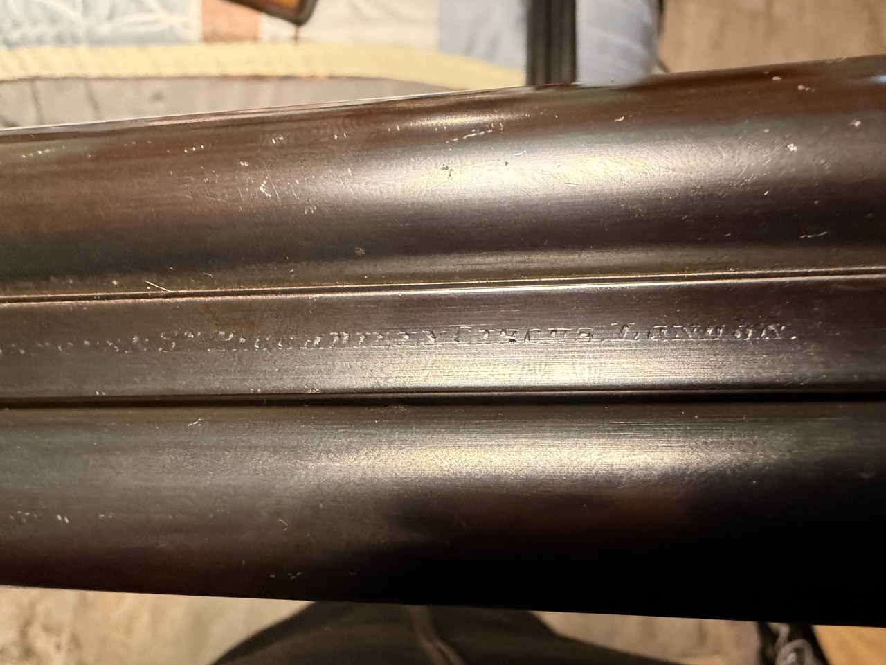

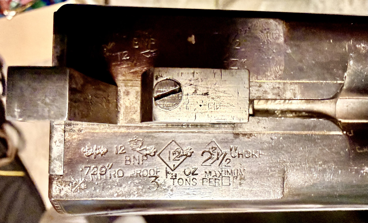

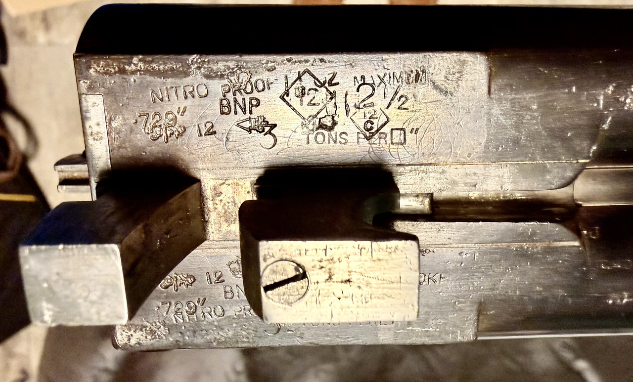

Listed on the auction site as Charles Osborne, but it doesn't say that anywhere on the gun, and the address on the barrels is "Something-Something-Something Picadilly Circus, London...which is how I know it's not an Osborne...
Your thoughts on what it might be?
Last edited by Geoff Roznak; 05/01/26 05:37 PM. Reason: Chnage post title to reflect new info

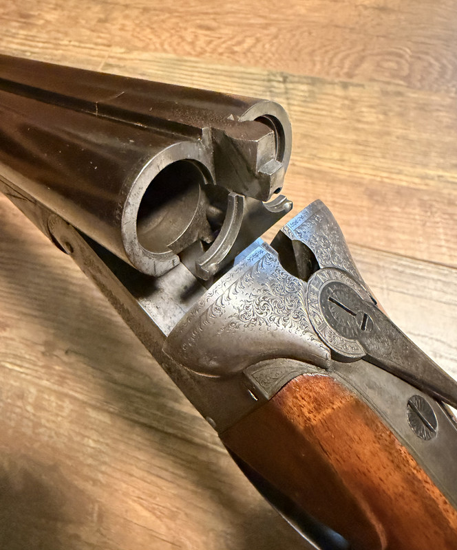

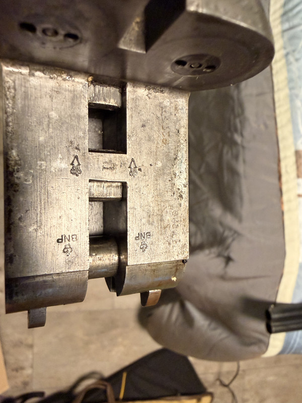

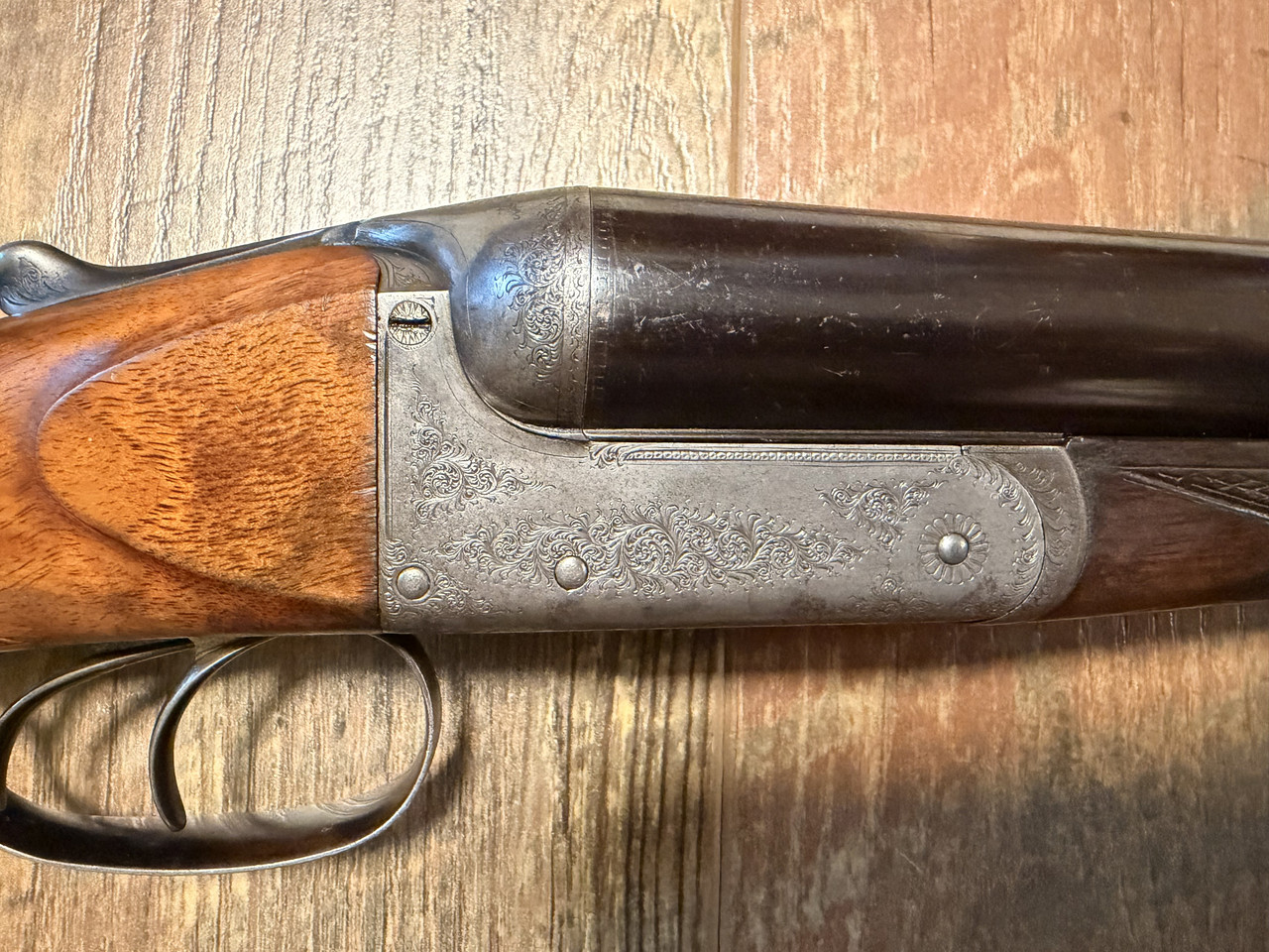

Wasn’t cyl/cyl when it was new. Disc set strikers, intercepting sears (better than good chance they aren’t there anymore) good quality piece. Looking at the action, I’d guess Webley & Scott sourced and finished in London.
But, it is only a guess.
I forgot to mention the Intercepting sears.
I'm interested why you think Webley & Scott?

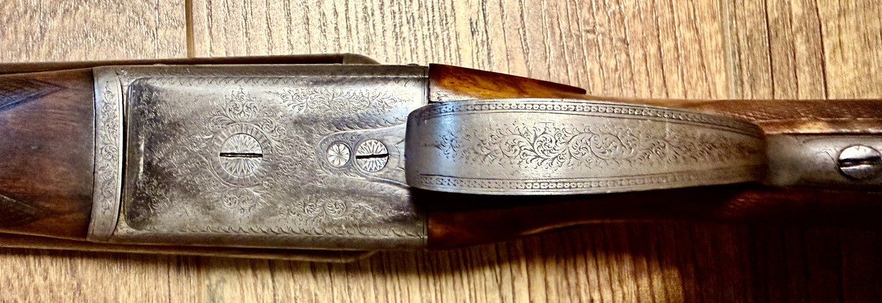

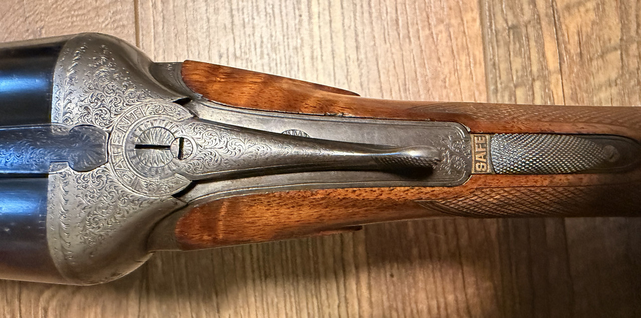

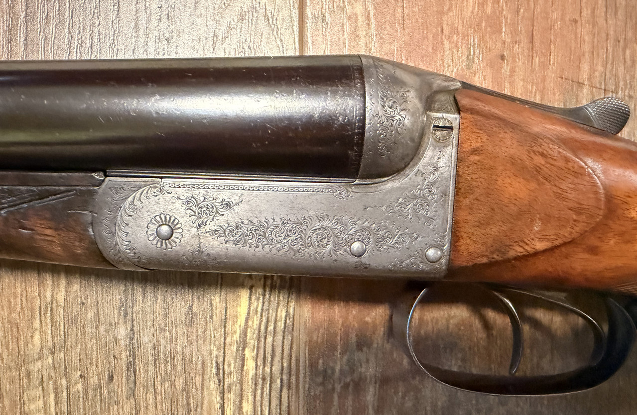

Its a Scott screw grip, the patent top lever is the give away.

Lever work in common with a few others I’ve seen.

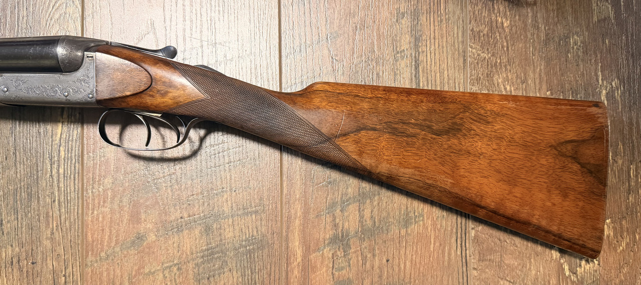

The lever is left of center, could be off face or close to being loose. Barrels are blued damascus, is it listed as having damascus barrels? Lots of knocks on the barrel flats and on the barrels in places.
It isn’t loose or off face.
Barrels are steel, not Damascus.
But I'm not looking for an evaluation, I'm trying to figure out what it is.
What makers (or retailers) were in London on Piccadilly Circus?

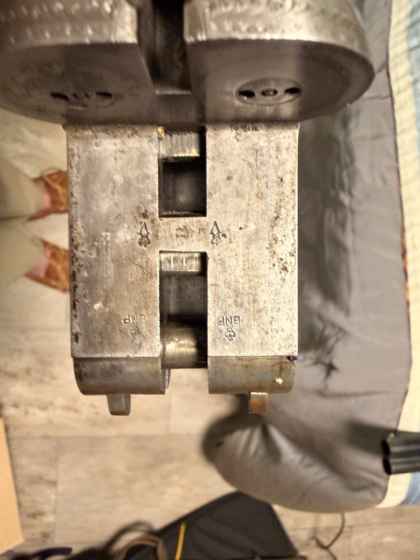

Have seen same action from william Evans, Powell, army navy and others.

Almost certainly an Anson & Webley action, universally used in the trade at that period . Could have been retailed by any gunshop , let alone maker . Sorry I can't assist further.
Regards,
