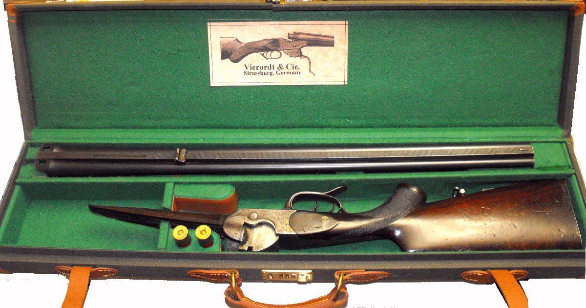

After I cleaned and greased and oiled all the inners, this thing locks up like a bank vault. It weighs in at 8-1/2 pounds, and now lives in a take-down case.

Nice effort on the ID and this proves that indeed, the 9,3X74R was under the "108/49" Plug Gauge Umbrella.
Also, Fantastic Effort on the Case as a Custodian giving the Ugly Duckling a Place of Respect & providing a Good Home for the unique German Mousetrap(Büchflinte).
