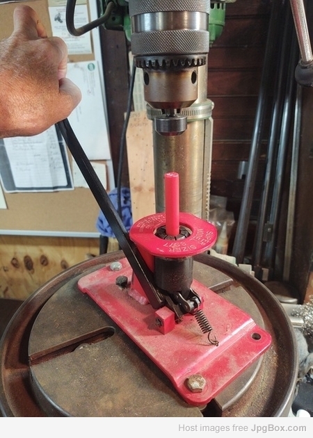

This is my setup for roll crimping. Drill press and a MEC Super Sizer. The SS does double duty. It resizes the case heads then, when bolted to the drill press table, it is the best case holder imaginable.
3 members like this: coosa, Lloyd3, Ted Schefelbein
