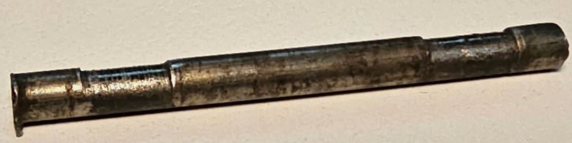

Ordered a set of 12 gauge hammers and a pin off of Flea-Byte. The hammers are a scosh over .250 thick and the through-hole is @ 0.130, the pin is 1.455 long with a diameter of 0.125, there is some scoring around the pin where both hammers pivoted.
The hammers are swinging free. It would take a LOT of fouling to gum those hammers up. While measuring the through-hole on the hammer, the Starrett 831-A half-ball small hole gage found some rough drilling finish in the bore.
Probably could take a pass with a reamer to smooth out the bore to a uniform 0.130 , this would NOT tighten it up, or loosen it.
Found a supposed Hammer Pin on Flea-Buy. Notice the two worn areas on the shaft where the pin passed through the hammers. The ends look rough as heck, not dressed like original pins.
Of course, we can't be sure if this is actually an original pin. Might be a replacement that is Cold Rolled Steel [CRS]. If you look at the wear pattern, it seems the wear is concentrated towards one side of the shaft, while the opposite side looks to be fairly close to the original diameter.
Worn Nitro Special Hammer Pin

As far as reaming the hammer pivot hole out to remove orig rough drilling finish,,I wouldn't bother as long as you say the hammers pivot fine.
These were inexpensive, mass produced firearms and made w/o any of what you could call fine qualities of fit and finish.
Also the hammers IIRC are case hardened. So unless the reamer is carbide, it will probably take a beating trying to cut the glass hard surface in there.
The pin shown is likely a soft steel replacement. Even with that it must have taken a lot of pivots back and forth to wear it like that.
That pin is probably undersize and that would accelerate the wear. ne end looks like they peened a 'cap' on it to help retain it. amay have ahd one on the other end as well but it sheared off when disassembling.
If the hole in the hammers and frame is .130,,I'd almost bet the replacement is a piece of 1/8" (.125d) round stock.
Close enough for a quick replacement in someone's world..like Afghanistan maybe.
The wear like that comes from one side of the hammer being under spring tension against the pin, and the pin being very soft steel
The other side that is not worn has the pivot hole riding free of contact for the most part so little or no wear.
Make a new pin of some decent tool steel and it will outlast your shooting days.
Or search for another pin that looks normal. They'll all be about 100 y/o, so don't expect a beauty queen of a replacement.
Numrich has them listed for around $5.
Says the same pin is used for the sears, hammer and cocking cams.
