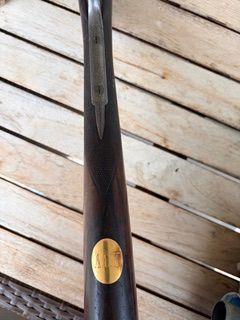

One detail particularly interests me: there is a gold oval escutcheon in the stock engraved with the initials:
A.C.M.
I would really like to discover who A.C.M. was and whether these initials could belong to an original or early owner.

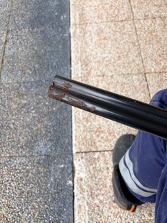

Regarding condition, the gun is not perfect but presents well for its age. The visible pitting/corrosion appears mainly concentrated near the muzzles, over approximately the final 10 cm / 4 inches of the barrels. I have not yet had the barrel wall thickness professionally measured.

I would also very much like to identify the original customer, particularly because the stock has a gold oval engraved “A.C.M.”

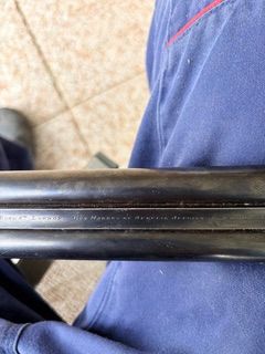

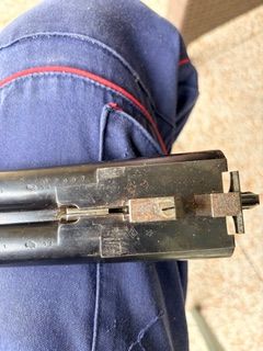

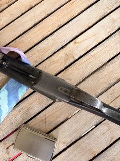

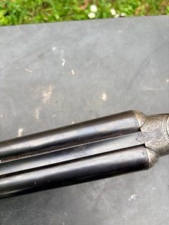

These were the most useful of the photos sent to my email:
[Linked Image from i.ibb.co]
That wasn’t a cheap gun when it was new. I love model C lever work, and the scalloped back frame, others will delve into the proof marks. We are probably going to need higher resolution photos of the flats.

Thomas I can’t see the proof marks well enough to read them. The gun looks like a detachable (drop) lock. WR didn’t come out with the detachable lock until 1897. You should probably work on getting the rust off the end of the barrels.
