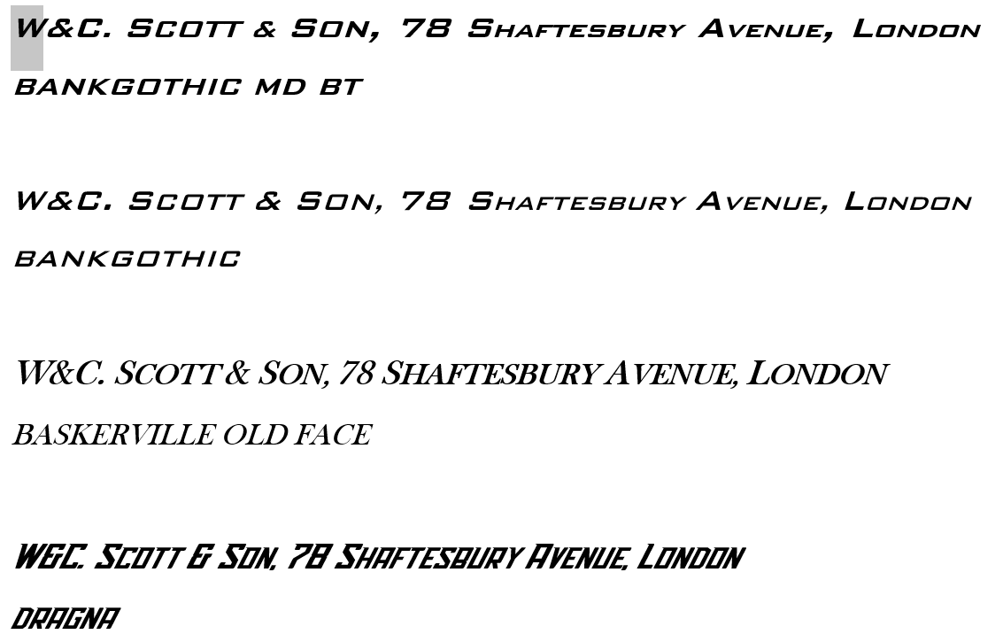

Thanks Drew for your font option, it is very nice
So far I have the following. Letters are 11, and first one is 13, so there is an increase. Bold and cursive
What do you think??
