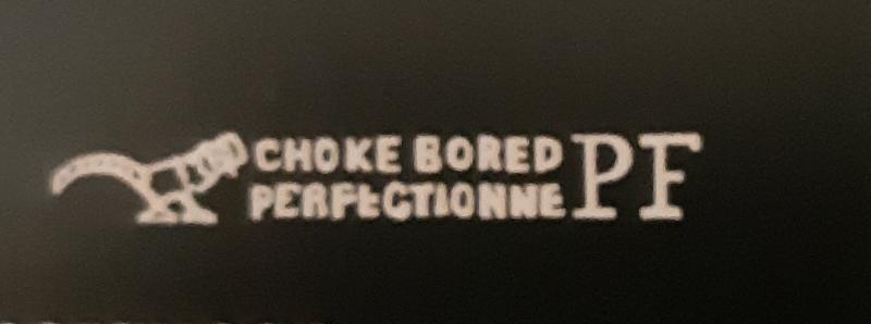

Burch, I'll try to help a bit but the photos are very murky. We could also use photos of the water-table.
Ronchard Czieron (under the name Didier & Cie at the time) appears to have made the barrels or at least the tubes. The gun was made after PT powder was introduced in 1900 and after the ACIER COMPRIME press trademark was registered in 1904 but before the chamber markers reverted to mm... around 1924. Explanation:
-- PT - Proofed for PT means made after 1900.
-- 6.5 - chamber measured in cm; means the gun was made between summer 1889 and 1924.
-- DEPOSE; ACIER COMPRIME: As Darnation said 20 years ago, Ronchard Cizeron, well known barrel maker in Saint Etienne (running hare logo) died in 1899. In July 1901 his widow amalgamated Cizeron with Didier & cie (founded by Jean Pierre Didier) with Madam Ronchard as primary stock holder. The trademark press with "acier comprimé" (compressed steel) was registered in August 1904 by Didier & Cie.
https://doublegunshop.com/forums/ubbthreads.php?ubb=showflat&Number=632317
-- Malot à Reims - As JayCee mentioned 20 years ago, this is the retailer. I can't identify who this is. The French databases can be a bit finicky or maybe I haven't learned to use them yet. Could use a better photo to confirm the spelling.
-- GRAND PRIX incased in a circle - Have to identify what this might refer to. Cizeron won prizes.
-- Choke Bored; Perfectione. - PF: PF could be the barrel borer or choke borer. Cannot identify him.
-- Rampant Dinosaur poinçon: I have seen this stamp. It is definitely not Ronchard Cizeron which was a running bunny. I didn't record it in a place I can find on my computer will continue to look:
As for strap, I can't help. Not sure it's so important. As Larry mentioned that is an unusual stock, more Germanic and rifle-like. It has more a straight up pistol grip and not the French half grip.

Salut,
[Linked Image from i.goopics.net]
Il est possible que la marque au faisan soit une marque de Ronchard-Cizeron.
Je l'ai vue une dizaine de fois sur des canons de fusil, et à chaque fois c'était des canons Ronchard-Cizeron.

Ah merci Fab. Excellent et Bonne Année. (Note that FAB identifies the mark as a pheasant and that it was possibly used by Ronchard Cizeron.
Quand je pense au poinçon de Ronchard Cizeron, je pense au "lapin qui court."

I have been informed that my description of the running rabbit symbol in French is silly, kind of the equivalent of a "hopping bunny." It should be "lièvre en plein course" = "running hare" The difference being you don't hunt bunnies or rabbits; you raise and eat them. You do shoot hares.
