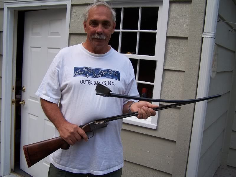

I would not reload them. I shot with a friend who reloaded 28 and .410 Estates. More then once the front part of the shell separated from the rear of the shell. He called them 'zingers' and re-shot the bird. The last time he did this was when the front part stuck in the choke area. Fortunately, he checked the bore. I hate to think what might have happened if he hadn't. It just isn't worth it for my money.

Hello Paul,
The last shells fired through this gun were reloaded Estate 28 ga. shells.----Just in case you need a little more input. (no blood let). All we found was the back half of the shell.
