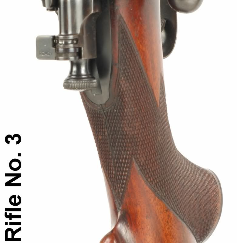

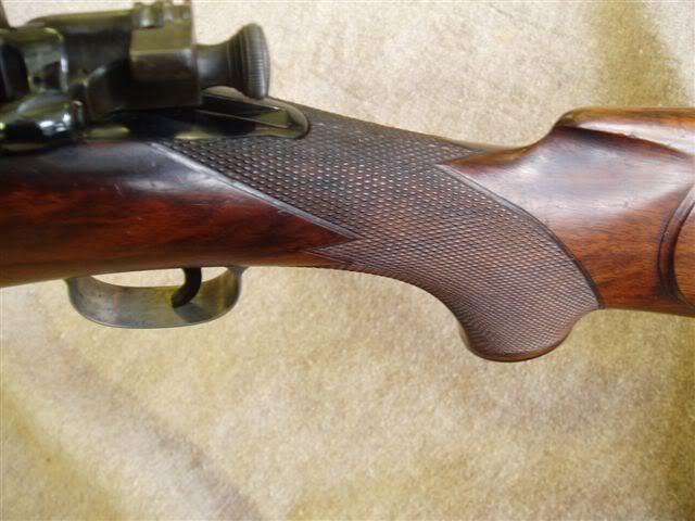

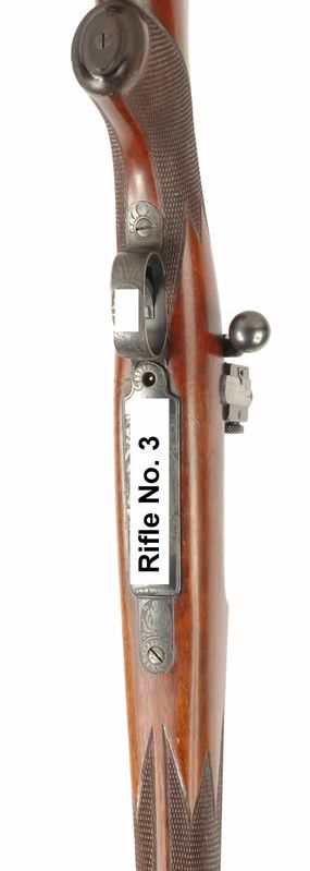

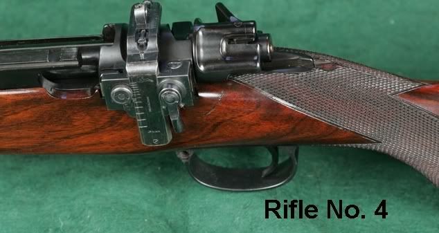

Now he is using a grip cap and running a border around the checkering on top but still running the bottom checkering into the hole.
I know that none of the three rifles pictured in this thread are marked by the maker. A least two people who read these threads have a rifle by this maker but theirs are marked so they may not have notice all the things I just pointed out. My question is who has a rifle that might fit the bill here? No need to name the maker but do you recognize the work?

# 3 looks like it has a Wundhammer grip swell, perhaps the others also which would explain the apparent thickness of the grip. It makes the grip cap look smaller in daimeter than the grip. The inletting looks very tight on all three and the way the checkering joins at the top of the grip looks similar but not identical to the way Rodgers (I think, I'll have to check your book) joined checkering at the front of the pistol grip. I don't know how he managed to cut right into the inletting on the Mauser tang without knocking out even a small chip.

We can call the this maker Mr. Lion for a while to keep all the different ones out of this. There is a lot more to his work than what I pointed out, he liked a Schnabel forend, long forends, did not like cheek pieces, most of the engraving is one animal on the floorplate with owners initials on the trigger guard. A lot more to his stuff then what is pictured. Do you think you could ID a Lion rifle from what you have seen so far?

Mr. Lion seemed to keep the same layout for his checkering from rifle to rifle.

Non of the guns have hinged floorplates.
