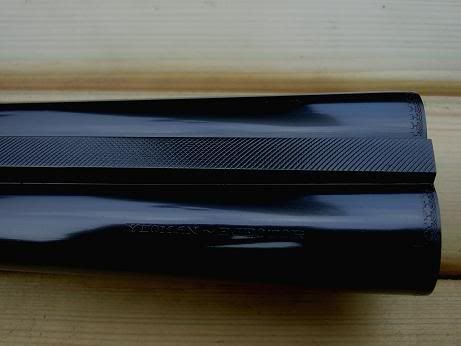

Rust blue is the best finish for a side by side, I would never use salts on any barrels brazed or not, even braized barrels have holes in, I only ever use salts for actions trigger guards etc, I call my barrel finish blacking., my damascus work browning, and the small bits blueing, but why do we say blueing? because the finish is not blue its black?
