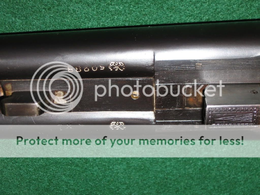

Circa 1900, several U.S. of A. makers offered double barreled guns with "Crown Steel". From some of the pre-1900 Sears & Roebuck catalogues and other ads, the 1st offerings may have been as early as 1894/1895. Whiteley Steel Company of Muncie, Indiana was incorported on December 20th, 1897 and they used the traded name "Crown Steel" on tool steel and possibly steel for auto, which was a mixture of imported ingots or imported ingots. But I think they were a little late to the party. Another option is the Crown and Cumberland Steel Company of Maryland. Does anyone have any info on the "Crown Steel" tubes. Interesting how other steel offerings were blue steel, Rolled Steel(Winchester), Crown Steel, Ordnance Steel, Krupp steel, Whitworth Steel, etc. with the component percentages being a secret.
Posts: 9,431
Likes: 316
Posts: 9,431
Likes: 316
Hunter Arms used "Crown Steel" from Sanderson Bros. Steel, Syracuse on No. 2 grade guns starting in 1895, then from Crucible Steel on Trap Grade guns after 1913
On Lefever guns the SB&Co (Sanderson Steel) a Sheffield, England, company, stamp many times also had a diamond or rhombus shaped stamped near the SB&Co stamp. This may not have been a Sanderson trade mark as it has also been found on barrels marked LLH. SB&Co appears in the Syracuse city directories of the 1880's.
In the 1880's English exports in the gun trade to the USA started a steady decline. SB&Co had the foresight to set up a plant here. This allowed them to avoid the disastrous fate that would hit other British firms with the McKinley tariff of 1890.

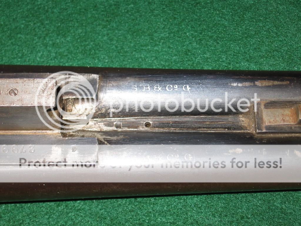

Bro. Walt set us right regarding SB&Co about a year ago. These are 1906 12g 00 'Armour' steel barrels with the 'C' for Crucible Steel.
S. Buckley & Co appears in the Syracuse city directories in the 1880s, and their mark has been found on Ithaca barrels also. No idea as yet what the ? 'P' is.

Very interesting thread, thanks everyone!Raimey's last post hit on Baker, which has many SB&Co marked tubes. Has any one ever seen the marking on a Syracuse Arms barrel?
Thanks again,
Craig
Posts: 6,275
Likes: 205
Posts: 6,275
Likes: 205
Craig, I am going on memory and have not checked any of my Baker guns, but I don't think I remember Baker tubes marked SB&Co. Can you give any examples on particular Baker guns with that mark ? Thanks, Daryl

The little bug (SB&Co) shows up all over the place. I have never heard of SB&Co-G until now. Craig, if you can post pictures I know I would find them interesting. At one time, I believed I had this figured out. Now, I am only sure that I don't.... I had thought the rhombus was associated with SB&Co. After all of Raimey's digging and questioning, I no longer believe that. Presently I am leaning towards the idea that the rhombus was an exporter / importer mark. The problem is that the more guns that surface with these marks, the harder it is to put it all together. If, as you say there indeed is an SB&Co-G mark, well.... back to square 1 again.
PeteM #185553 04/11/10 12:18 PM
Joined: Dec 2004
Posts: 667
Joined: Dec 2004
Posts: 667
Pete, I sent a pic to Raimey, and will send one to you also, along with a pic of a Lefever mark I had not seen before.
Daryl, I was wrong, I was thinking of ADH on the Baker barrels.
As an aside, as I am pulling out guns to photo, my wife wonders by and tells me if you can't remember things you must have too many!Think I will go shooting!
Craig

Do we have these "SB&Co.?" marks:
"SB&Co. C"
"SB&Co. G"
"SB&Co. P"
"SB&Co. T"
Have a missed one or added one?

Enlargement and rotation of the mark on the Lefever tubes:

Drew:
Back to your Belgium source question: are there L.C. Smith examples with "SB&Co. LLH" post the beginning of WWI, when does the examples with "SB&Co.-C,G,P,T," seem to appear and are there any examples stamped "SB&Co.-C,G,P,T" coupled with "LLH"? Would you think that the designation for "SB&Co." could be time dependent and for S. Buckley & Co. until a certain date and then for Sanderson Brothers & Co. thereafter?
Posts: 9,431
Likes: 316
Posts: 9,431
Likes: 316
Brother: you mostly lost me when you wandered off after this new fangled fluid steel stuff smile
We've found pre-1913 Smith barrels with SB&Co P and C
We've found post-1913 barrels with the crown over a 'D' mark of Jean-Baptiste Delcour-Dupont of Nessonvaux.
We've found post-1913 with LLH as late as 1940.
No SB&Co with LLH.

Here we go again smile
1906 12g 00 Smith with 'Armour' steel barrels marked S.B. & Co P
1910 F grade Smith hammer gun ROYAL STEEL stamped over S.B. & Co C
SB&Co G on an Ithaca Flues courtesy of Craig Havener
A VERY DIFFERENT 'SB&Co' on a 1920 Ithaca Flues Field
ALSO STAMPED 'LLH' of Laurent Lochet-Habran
I'm thinking the Smith SB&Co is Sanderson and the later Flues is Samuel Buckley.
The earliest Smith with 'LLH' we've seen is a pre-1913 20g ALSO STAMPED 'ACL' - Acier Cockerill Liege.
