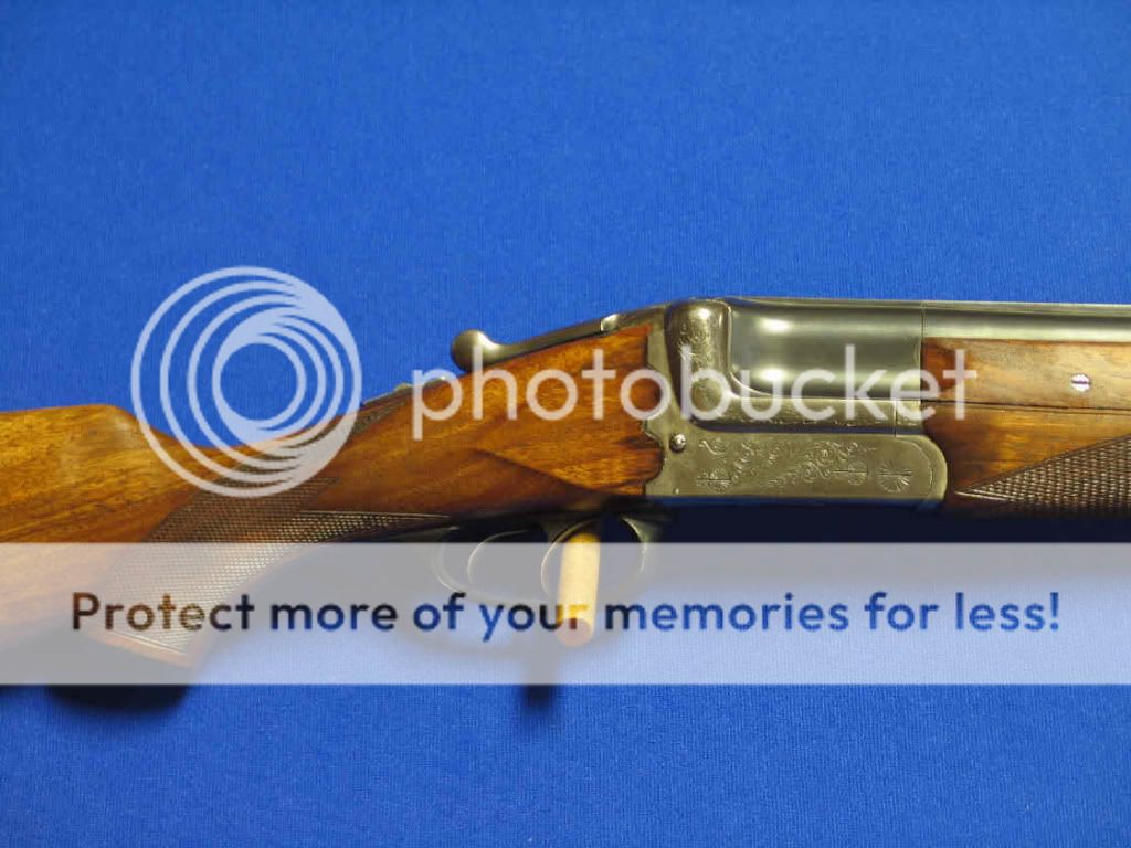

Precisely Lapin.
And as per your photo this was the engraving mine had:
