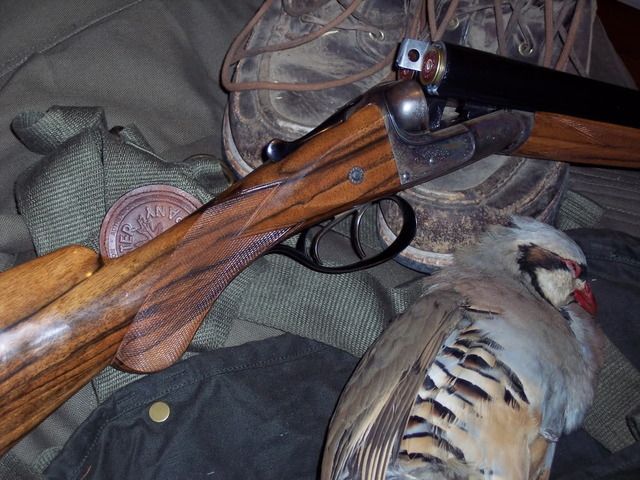

More than likely...that Greener would have left the shop with a checkered rear end. If the pad is a high quality pad like a Silvers, Pachmayr "old english", etc, and properly installed, I see no reason that should detract from the value. Noticed I said "properly" installed.
The FH25 is a sweet gun, the facile princeps is arguably the nicest boxlock action to come out of Britain, certainly one of the most attractive. When I had mine FH25 restocked, the stocker called to tell me how impressed he was with the "guts" of the gun, every single part was polished like the insides of a best gun. Greener took pride in building every gun that left the factory and its these "little" details that set Greeners apart from many other makers.
