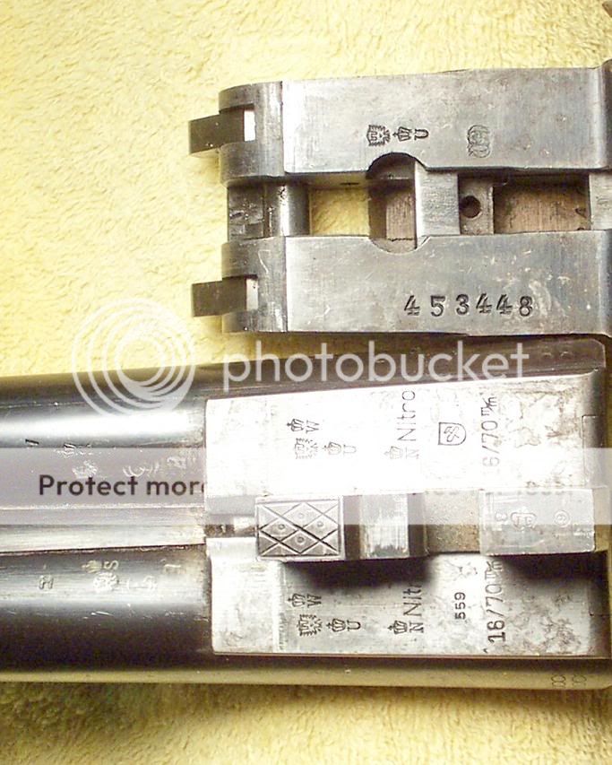

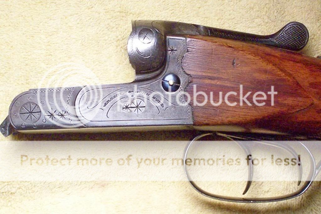

I have an East German made, "J P Sauer - Suhl", 16 ga gun, proof dated May 1959. Near the breech near the top of both barrels is stamped four interlocking rings. This symbol is recognized as the Olympics Logo. I understand that at some point E-TW ceased to use it under threat of a lawsuit.
My questions are (1) when did they first use it, (2) for how long, and (3) what prompted them to use it in the first place? Was this stamp used on products for sale to the Eastern Bloc only, or for general distribution?
I believe that at one time Suhl was the center of East German competitive shooting sports. However, I do not know if these matters were related. Thanks.

Yes, there is a "Q" with a superimposed "1" on the left side of the rear barrel lug.
The four rings separate "Special-Gewehr" and "Lauf-Stahl S.G.1" I have wondered if that stamp was somehow actually related to the material, or in imitation of the old three ring Krupp Logo.

I'll look later tonight on a few post WWII examples but can you email or post a pic of the verbiage. You are correct though it should say "Spezial Gewehr Lauf Stahl" - Special Weapons Grade Tube/Barrel Steel. I'm puzzled by the "S.G.1" for now. The "1" in the "Q" is the top/outstanding quality mark. What's the name on the underside of the tubes, Simson?
Posts: 3,774
Posts: 3,774
Yes, 4-rings was related to material, according to some Soviet publications in press it was Russian barrel steel 50A (S.G.1).
But there is one question where did GDR get barrel steel when all pre-war and war time German steel stock got empty? Definatly from USSR. There were 3 types of Russian barrel steel for hunting weapons: 50A, later 50AR and chrome-nickel steel 30CrN2МF (Boler Blitz analog) mostly on GDR Merkel's and other high grade GDR guns.
The story with 4 rings "Krupp" steel is not quite clear. Guns for export to the West or because Krupp family was in West Germany and claimed ther rights for 3-ring trademark.

Good eye Geno and now I really want to see the barrel stamps. Geno are you saying the Russians borrowed the Boehler Blitz steel composition?

Not sure about steel composition, but from press this steel very much alike Bohler Blitz by quality. This steel been used on the best Russian MC guns.

I will take and post some photos of the stamp marks as soon as I can take them and figure out how to include them.
Both barrel tubes just ahead of the flat, and the water table, are stamped with the "SuS" Sauer und Sohn monogram. On the barrels it is only partial.

The four ring Krupp steel mark has been discussed several times, Geno seems to be correct in that it was a higher grade of steel used by Krupp, and it appears on post war guns. Here's one example from my guns, there are others:

That is the same text and logo that is stamped on my barrels, including the "S.G.1".
I had not found earlier discussions of the four ring logo and would appreciate the reference.
Is the four ring logo actually for a Krupp product, or is it an imitation? How long was it used?

I don't think Krupp had anything to do with it and it is some Russian steel variant, which furnace, I can't say. I've looked at a few examples some with the rings, some without and there's nothing I can see that relates back to Krupp. SpeZial Gewehr Lauf Stahl was Krupp's and this type steel was to mimic Krupp's. The phrase is odd in that it mixes English & German. I can't find any reference to 4 Rings for Krupp.

It appears that I (and apparently others as well) have made a poorly founded assumption, based on many examples of the well known 3 ring Krupp logo. I have three examples of the above 4 ring logo, all on post war J P Sauer guns, one dated 1957 and two dated in 1956. The logo stamps are all as per the photo above. I simply assumed that, since the famous 3 ring logos were Krupp, this 4 ring mark was as well. But, NONE of them say Krupp!! Since this was after the Russian take-over of the Suhl gun making factories, I believe I'll now go with the WAG above made by Raimey, which attributes the steel and the marking to a Russian variant, or counterfit of Krupp.
I also remember another German logo with 4 rings: Auto Union. That might have factored into my initial belief this marking was a genuine German (Krupp) mark, although the Auto Union 4 ring logo is straight horizontal.
That likely makes the values of post war Sauers even lower, at least IMO. I have shot this steel, and it handles modern loads well, but I also don't think this is a Krupp product. That'll be my stand until proven otherwise.

Apparently the Russian did know much of components of Krupp's Spezial Gewehr Lauf Stahl, patented in 1896???:
0.61% Carbon
0.04% to 0.43% Phosphrous
0.65% Manganese
0.65%(??) Silicon
0.04% to 0.43% Sulphur
And I'm sure other countries did also.
Sure Chief it is a pretty wild guess but with some foundation. As Geno posted earlier, when the craftsmen of Suhl, of those who were left, expended/extinquished their stock, where else could they turn for tube steel? Also I'm sure Russian was a big client and many have prefered Russian steel??? First of all it's always about economics and just like the hypothesis of the Belgians making Krupp steel scattergun tubes for the American market, as long as the composition, or percentage of components, of the tube steel is very close to the same, I don't know that I would devalue the post WWII German examples without knowing the same. If an example is made by the same craftsmen with the same components as pre-WWII examples, although maybe with components from a different facility with a different stamp, how does that make it a cheap product? The same techniques apply today as it is much easier to build a plant manufacturing your product in another country with the same components and with their labour as it is to import the finished product or import components and make the product. One doesn't really know what they have until it is broken down into it's primary components.

Well, I'm going to have to somewhat revise my statement to include the loss of craftsmen and post WWII sourcing, which between 1949, which saw the division of Germany, and 1953 lead to a dip in quality and I think is what gave post WWII examples a bad name due to the fact that the sourcing of the West had become non-existant and the fractured group of Suhl craftsmen "made do" with what they could find and expending existing stock. There was a revolt by the German craftsmen, and I'm sure Suhl was strongly in the mix with the revolt being founded on the fact of not being able to deliver a quality product which was tradition and expected by the Suhl craftsmen, in 1953 which was brought under tight control by the folks in charge and Russian took full economic control of Suhl, and I'm sure East Germany/DDR. So taking control also meant providing sourcing possibilities or components. So in September 1955
Izhevsk crucible steel grade 50A was substituted for Krupp steel and Izhevsky introduced the "Four Rings" to distinguish the two. I think the Izhevsky "Four Ring" steel had an elastic limit at 50 kg/mm^2 and a failure at 80 kg/mm^2. There numbers are accurate but I'm not sure about the description of the limits.
So let me say that I think that the bad press stamped upon post WWII German arms wasn't due to the craftsmanship per se, but actually to the inability of sourcing quality components. And I believe this to have occured between 1950 & 1953. As always I entertain any and all info or opinions.

Originally Posted By: ellenbr
I think the Izhevsky "Four Ring" steel had a failure limit at 50 kg/mm and an elastic limit of 80 kg/mm.
Vice versa, Raimey. 50A elastic limit 55 kg/sq.mm and failure limit 80 kg/sq.mm.
Elastic limit means force, when steel begins to stretch out. Failure limit, when steel breaks.

The stamp of "Special Gewehr Lauf Stahl" was used with the 3 Rings and this example may have been in the last of the ones from Suhl with Krupp tubes: http://www.gunbroker.com/Auction/ViewItem.aspx?Item=151981163

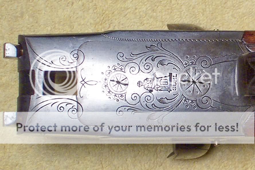

Here are a few images of my August 1951 marked Sauer, my left rear locking lug has all sorts of markings ?

FJS's 1959 Ernst Thalmann Werke Sauer example:
I'm guessing around 400k that Sauer changed to IZH crucible 4 Ring Special Gewehr Lauf Stahl and IZH had to began offering the steel type in 1951 because 1950 saw the last of the Krupp steel tubes and of course there may be exceptions.

Raimey - do the stampings on the locking lugs of the East German Sauers have any relation to quality ?
I found it interesting that on my 851 prooved Sauer that germany was stamped below the four rings, instead of GDDR or something.

Sorry postoak I forgot to reply to your post and ask what the 3rd pic was. 1 was good quality between Outstanding quality and utility grade. I'm still searching for info on the date of the "4 Ring" steel but it had to be in the 1950-1951 period.

The use of the 4 Ringe Gewehr Lauf Stahl was an attempt to deceive the end user was getting tubes of the same Quality as the coveted 3 Ringe Gewehr Lauf Stahl by Krupp. 4 Ringe Special Gewehr Lauf Stahl - Gewehrlaufstahl was actually made @ Edelstahlwerk Freital and sourced from Edelstahlwerk Freital. So that is the word from the authority in Suhl.
>>ESW<< denotes Edelstahwerek.
>>BGH - Freital Edelstahl<< supplied steel to Ernst Thälmann Werke and other mechanics in Suhl.

Evidently, the switch from Krupp Steel or Böhler Steel to Edelstahlwerk Freital 4 Ringe Gewehr Lauf Stahl / 4 Ring Weapons Grade Barrel Steel was all due to economics. East Germany had a shortage of foreign currency and had to source inland. Scrap Metal quality varied vastly and there was a dip in quality and everyone including the end user was forced to embrace the change. This is exactly the reason that many German Collectors give a hard knock on GDR weapons platforms.
Merkel may have been the exception and was not under the Ernst Thalmann Werke umbrella and was able to negotiate their barrel steel?
