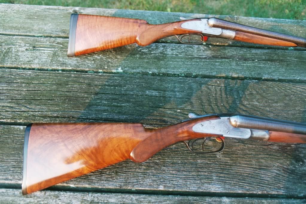

I realize that these are not the best of pictures, showing the forearm. On the B's and A that I have, the forearms are all very similiar if not the same. [img][IMG]http://i33.photobucket.com/albums/d76/Dave45871/011_8A_0001.jpg[/img][/img]

Dave,
Thanks for the photo. Are there any forend tips in ebony or horn or some type of escutchion? You have 2 very nice looking guns. The butt stock wood needs to be cleaned and the recoil pad replaced.

I know it is hard to seen, but yes, there are ebony tips on the forearm. They are "V" shaped and rounded at the front. The tip extends about 1 1/2"-1 5/8" from the tip of the forearm and they are slightly wasp waisted to an 1/8" radiused tip in the back of the tip. The front of the tip is approx. 3/4" wide. I good way to inlet them into use the what Chris Schotz told me. Of course fit the ebony as good as you can, then glue it in with black Accra Glass. After Accra Glass is well set work, the forearm down to a final finish and it will look as if the ebony grew out of the walnut. On my "B", you can see the butt extension I added. When I got it, the butt had been shortened and an old and dried out recoil pad was still present. I chose to use the orginal style "Baker Gun and Forging" hard butt plate and made these extensions to get it to my LOP. Hopefully you still have the forearm iron as they seem to be missing in action from time to time.
