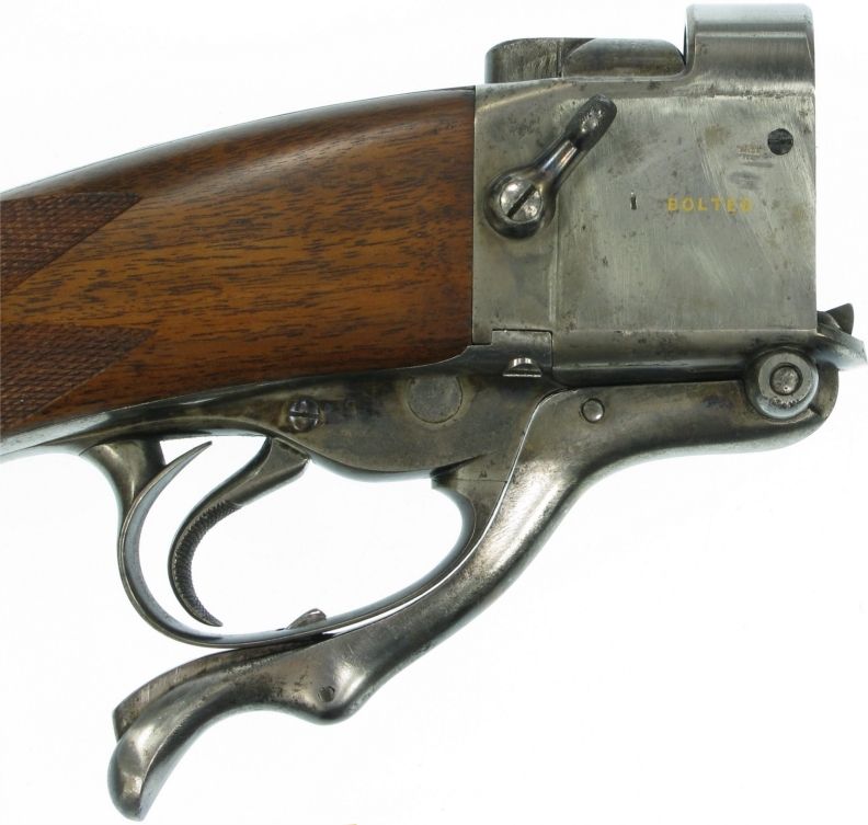

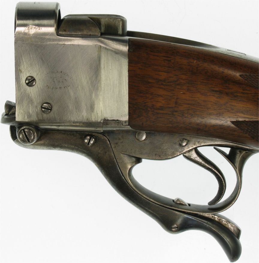

These are the pictures of it before the serious work has begun:

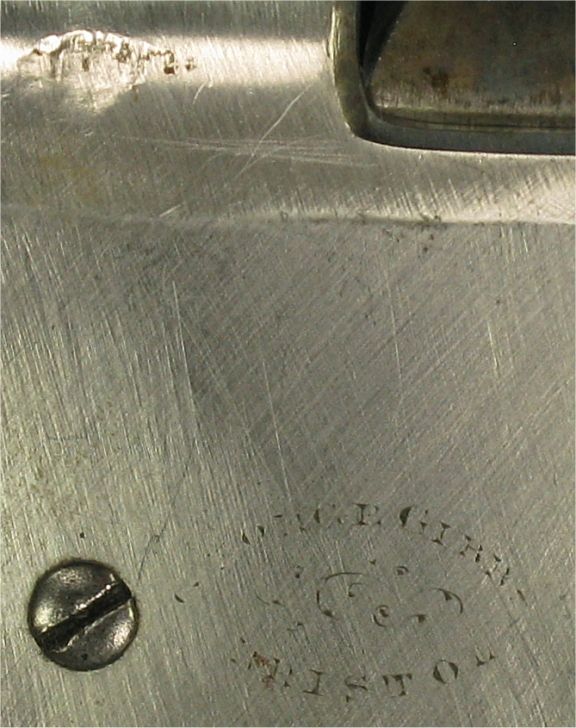

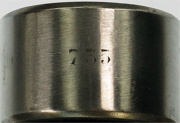

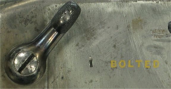

Here we can see where some one used a coarse abrasive to remove surface rust. This person has almost obliterated the George Gibbs logo. This Farquharson (action # 199 APU # 735) is reported by Jonathan Kirton as being rebarreled in .303 British. Both sides of the action were marred during this process. On Friday at the CADA show I will turn over the action to Fred Bowen of Lake Villa to work work his magic on it. I consider Fred to be one of the best engravers in the English style in the world. He will square up, properly polish and engrave it while hopefully sending me pictures of each step which I will post here.

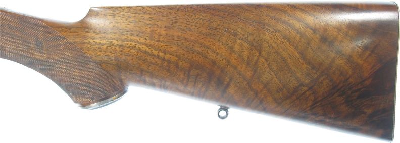

As you can see by the quality of the wood, this is a very worthwhile project.

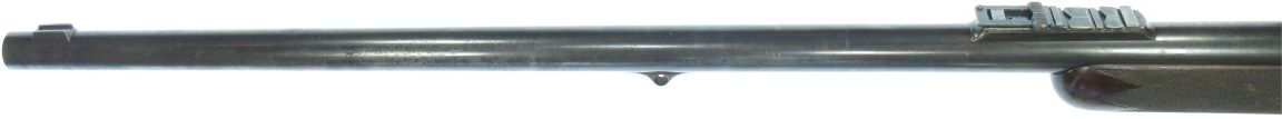

As with all projects like this, new problems crop up, but that is one of the reasons for starting this thread. With the barrel off I did a serious inspection of the bore and it is much worse than I thought. I have a number of big bore British single shots and love the idea of having one in .303. I emailed McGowen Precision Barrels and found they can provide a .311 barrel with the exact same taper as the present one. This is important because the taper must match the original so that the sights, swivel base and forend can be reused. Tomorrow I will have my retired gunsmith remove the sights and send the old barrel to McGowen.
This is the barrel with which I am starting:
