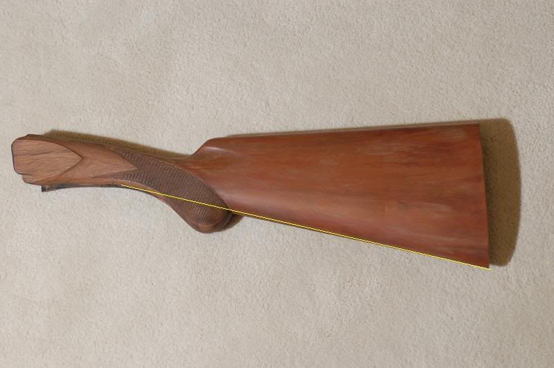

I think all checkering is removed and redone. If you take a straight edge and place one edge at the toe of the stock and the other at the point near the end of the lower tang, where the pistol grip turns down, you can see a line that would be the finished straight stock conversion. I believe the whole lower line of the stock is raised to make this line work.

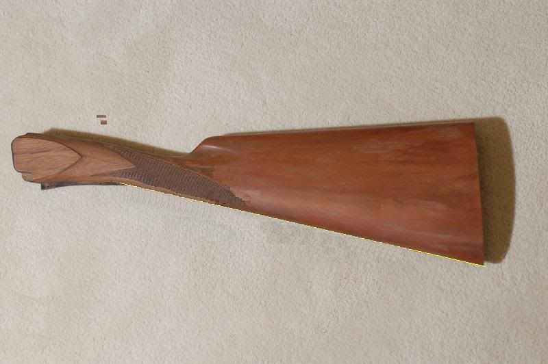

Please forgive my checkering skills as it was a rush job.
