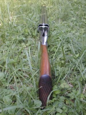

Ted:
I may be repeating myself but I found it interesting that my Charlin stock incorporates a method of achieving cast which resembles the cheek pocket which some trapshooters have been known to work very quickly into a comb but is more subtle and possibly original--whatever that may mean. A lot of castoff developed not in the wrist but by shaping the comb to curve to the right and then return to the butt, which is nearly on the plan view centerline of the gun. I have put both this gun and my AyA (also strongly castoff) on paper by the pull up and fire POI test. I consistently put the AyA left barrel pattern 70-30% laterally offset to left on a 3" black-painted aim point. The left barrel of Charlin shows no tendency to do other than center the pattern laterally.
jack

#1980 10/08/06 08:03 PM
Joined: Apr 2002
Posts: 6,812
Joined: Apr 2002
Posts: 6,812
I've posted these before but they are illustrative.
Gun is 1960's vintage so original owner might be around.
jack

I would think, in my infinite ignorance, that cast-off should (ideally) always be like the one above.
Michael Yardley does mention that cast (at heel) in one direction can cause a gun to shoot in the other, as in Jack's AyA, so one could conclude that the way the Charlin is cast avoids this.
JC(AL)

JC, I would speculate that the stock was got out to this shape rather than bent except that I can't detect dark areas of end grain which should border the depression or cove fore and aft if it were worked in that way. If it was in fact bent, it must have been a more complex job than a twist to the wrist. I think it would require a fulcrum between thumbhole and heel about which the stock was bent after shaping. Who knows?
jack

I didn't say that quite right. Not a simple comma shape but rather a sort of chicane of "S" so the stock would have to be bent over opposing restraints or fulcrums spaced a few inches apart.
jack
