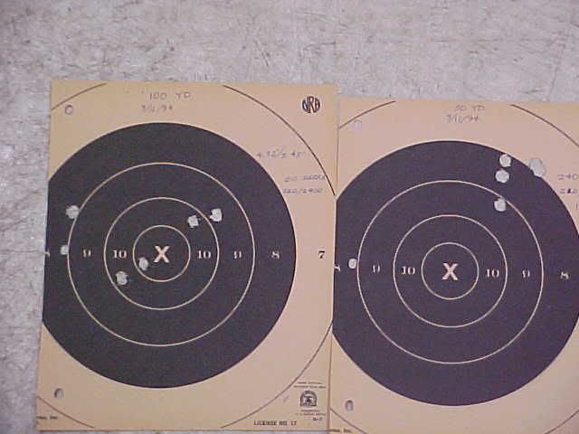

Steve, I'll see if I can find some of my old targets but IIRC I gave them to the new owner. (later) Success! Here are 2 of the best I've shot, one at 50 yds and the other at 100 yds.
The Magna Classic was a very limited-production M29 or M629, specially accurized and specially strengthened for shooting handgun silhouette with very heavy 44Mag loads. It came in a HUGE fancy mahogany case with a lot of extra front sight inserts for various ranges and sighting conditions. The full underlugged barrel and the round-butt grips made it too front-heavy for field use but it was QUITE accurate.
In 1990 it cost almost $1,000 (~ 2-3 X normal M29), I believe that was the only year they were made unless recently. I bought a stainless and my shooting buddy bought a blue one.
Both revolvers came with factory test targets fired from a rest at 50 yds, all six shots well under 2" using Federal 240-gr jacketed bullet factory loads. I remember feeling underprivileged because my buddy's test target was 1 5/8" while mine was only 1 3/4".
We loaded some Sierra 210-, 240- and 250-gr jacketed bullets with heavy loads of H-110 & 2400 and were both able to achieve less than 2" from a rest at 50 yds with all 3 bullets. Took practice and 110% TOTAL concentration but it can be done with the right handgun.
Regards, Joe

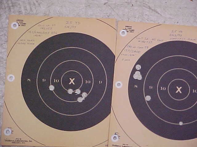

Steve, here's a more representative sample of my own shooting, with one of the most accurate Colt SAs I've ever owned. It's a 1st-gen, actually an 1894-vintage BP gun that someone reblued and I later rebuilt.
The flyers are present on almost all the targets shot with that revolver. I used mostly plain-base Keith SWCs (the coffee-can bullet) from a specially-sized Hensley & Gibbs mould that threw the old-style wheel weights to 0.454" as-cast, 265 grains with the lube. The first-gen 5 1/2" barrel grooves measured 0.454" and I substituted a 2nd-gen cylinder with throats measuring .455".
The early Colt dimensions are a mare's nest of conflicting & non-matching sizes, possibly the subject of a future thread. Let's just say that if you ever find an early Colt revolver that's REALLY accurate, IMO you better cherish it and hold it close, VERY close!
Regards, Joe
