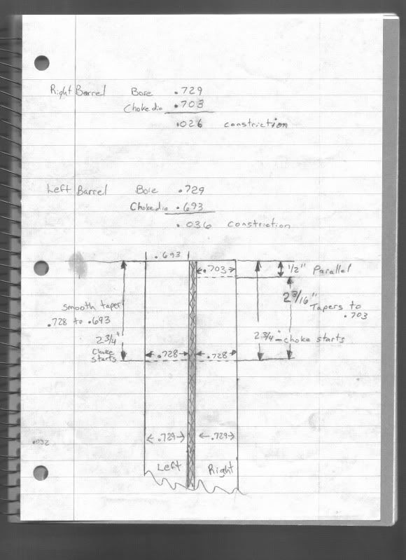

I am going to guess that maybe this choke missed the QC dept and didn't get finished. It is a Field grade gun and it looks like their newbies put it together. Finish metal work was really bad and it was also near the end of production 1949. If the choke gets the same 1/2" parallel the constriction should measure .032 which should be between Full and light full.
