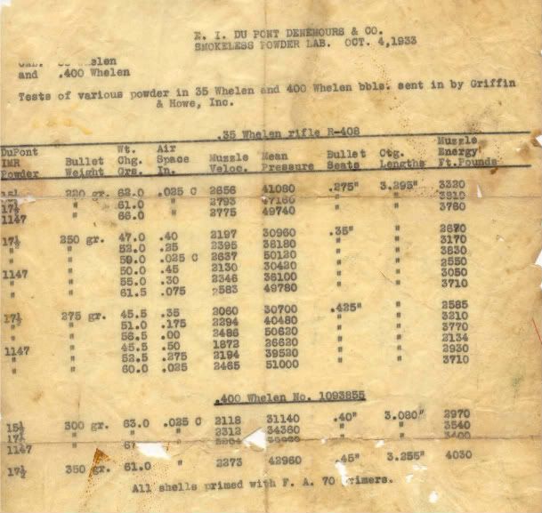

Although the powders are obsolete it gives one an idea of what they working with back in the day.
