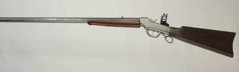

I ran across an ad a few weeks ago for a Ballard with a Winchester barrel. A Pacific action with DST. Was told the bore was nice and shiny ;-). Got the rifle a few days ago and it was touch and go about keeping it or sending it back. I keep telling myself I only wanted the action but it is an interesting rifle, of sorts.
We have not attracted as many single-shot folks to this sight as I had thought we would so if this is something you guys are not interested in I can skip all this.
Thought it may have some interest for new folks and most here are a bit more advanced.
Be prepared this is ugly!

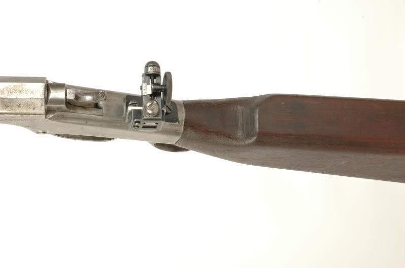

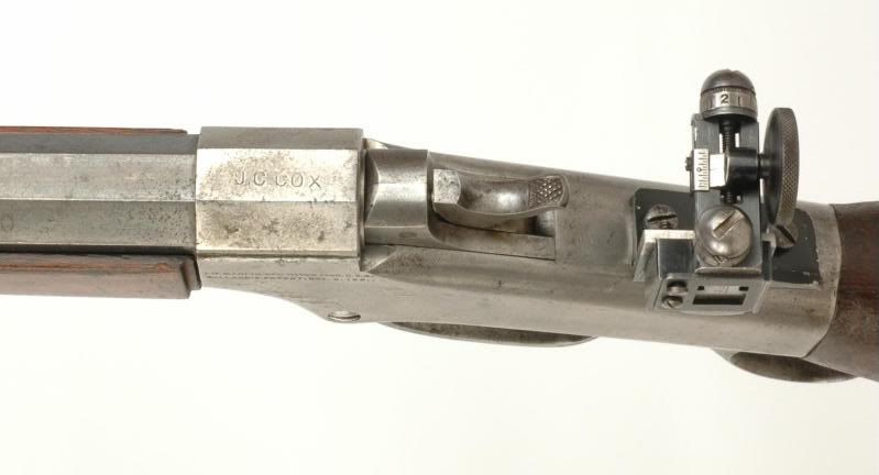

Michael,
There are a bunch of us that like singles but we seem to be overwhelmed, of late, with those dog-leg rifles.
What's up with the sight on that action? It looks like something made from something else, yet rather serviceable if not very elegant.
Nothing wrong with that action except the beating it took on the top of the receiver ring with those stamps. What's that all about?
Brent

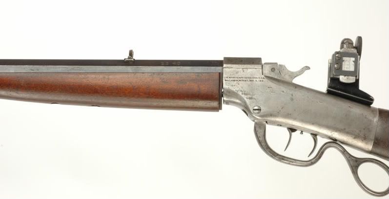

The good and the bad.
Every screw in the rifle needs replaced. The set trigger screw was missing and I replaced that yesterday. The bore is dark and worn for the first third of the bore, the rest looks OK.
The rear sight is a modern receiver sight on a angle aluminum piece, that all has to go.
The rear barrel sight is now gone and filler installed. A combination front I'll leave on for a while.
The barrel was from a Winchester High-Wall with an inch cut off threaded and fitted to the Ballard. The barrel a No. 3 that is 33" long so it must have been 34". The cambering job is very professional with a tight fitting extractor. The extractor is not like a Ballard and I had to take it up to my friend John's and we filed the extractor down so we could take the action apart. I have no idea how they could have gotten it together with that extractor.
The butt stock is just a piece of wood butted to the action and pulled tight with the through bolt. The forend is from a High-wall badly fitted, all wood has to go.
The name stamped on the top of the receiver is J.C. Cox I don't know if it was the owner or the gunsmith. There was a Kansas gunsmith in the 1880's named J.G. Cox. More research before I spread all the parts to the wind.
