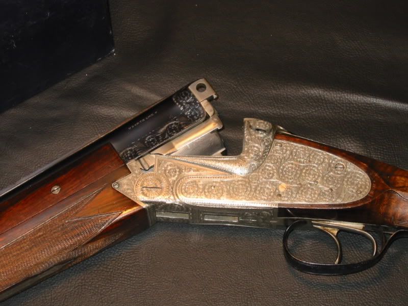

I wish I could take better photos, this is not a very nice picture of a very nice gun. I have both a 12 ga and a 20 ga, the 12 has a "coin" finish, the 20 has a color case hardened finish.
