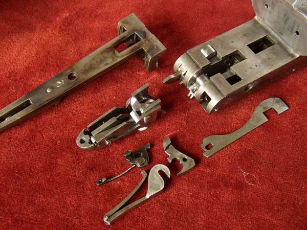

I can only echo Dustin, I can't understand how it can be a 'wristbreaker' but be 'assisted' in closing. A 'normal' wristbreaker is powered open by the main springs and as soon as one starts to close it one feels the, usually, heavy resistance of those same main springs. In fact if one isn't quite vigorously with one's closing effort, the gun bounces right open again. I wonder if your gun has an interesting variation of the 'normal' mechanism. It may be a lot rarer than you think!
I'll post a few pictures of the internals of Joe's gun that I took when restoring it for him sometime soon.

Here are the action components:
[img:left]http://www.heritageguns.co.uk/Lancaster%20BLE/Lancaster%20BLE%20Action%20600[/img]

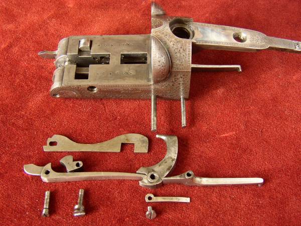

Here is the Block Safety:
[img:left]http://www.heritageguns.co.uk/Lancaster%20BLE/Lancaster%20BLE%20Block%20Safety%20600[/img]

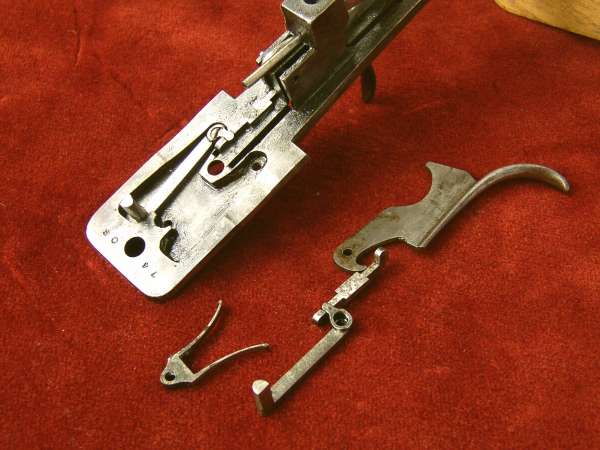

Here is the ejector work (a nightmare designed to get round the Southgate patent, the spring was once described as a 'snail of acid')
[img:left]http://www.heritageguns.co.uk/Lancaster%20BLE/Lancaster%20BLE%20Ejector%20600[/img]

Yikes, I'll never go exploring inside my Lancaster. What a bunch of cool little bits for me to foul up.
The gun has functioned perfectly since Toby's restoration. It is tough to close. I find by holding further out on the barrels when closing gives enough extra leverage to close-n-cock without too much effort.

Your Lancaster DOES cock on opening, not on closing like a Purdey. When a fired Wrist-Breaker is opened the front end of the spring/lever is depressed and the rear end rotates the tumbler/hammer back to the cocked position. When the gun is being closed, the cocking dog is raised and since the rear end of the spring/lever is now being held up by the tumbler, which in turn raises up the front of the spring/lever causing the middle portion of the spring to bow down. The cams machined into the action flats are there to increase the bend of the mainspring. In a nutshell, thats how the system works.
Dustin
