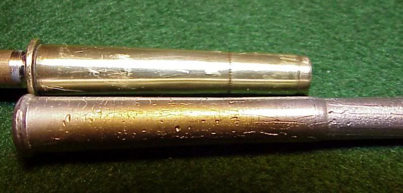

The chamber is cut with no lead, just a taper from the case to the bore. Looks like it was cut for breech-seating.

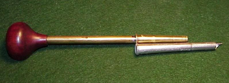

The breech-seater is one I made back when I was a kid and first started playing with schuetzen rifles.
I took a 32-40 case and drilled a 5/16" hole through the back and adjust the seater then solder it in place. I could not tell you how many times this has been soldered. When I find a good length I make a new one for that rifle.

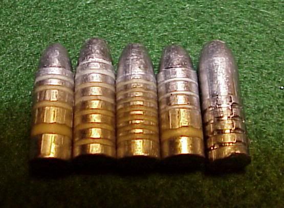

I have a pile of .32 caliber bullet moulds so I can try many and see what if anything will shoot in this rifle.
Can you see where the rifling marks stop just short of the base on the bullet on the far left? This is about where I like to start bullets and I have adjusted the seater for this.
