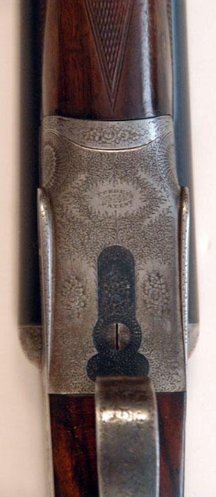

One thing I like about the older Purdeys is the generous tight scroll. Here's a comparison of the gun you are considering and a Purdey from the 1950's that was recently on Hallowell's website:
It doesn't take very sharp eyes to see the difference. The older gun has much better engraving.
Good luck with it.
