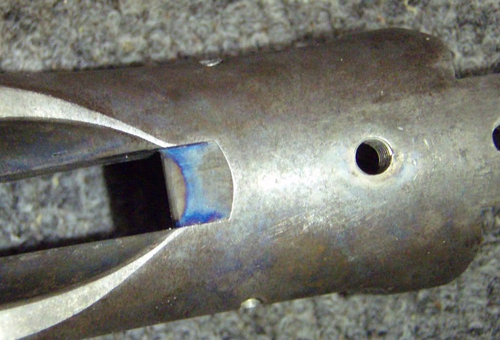

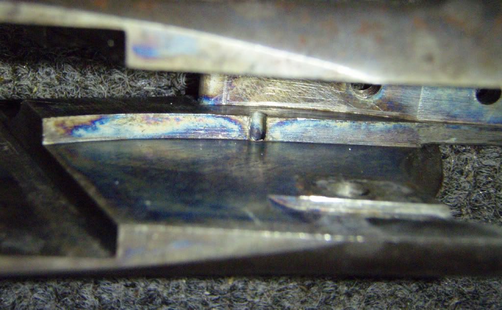

Michael,
I got one a couple of years ago after a visit to Abe Chabers shop. I heard a noise in his back room, a low buzz, I asked and was shown the little tank at work. Abe then cleaned a Highwall action I had disassembled and I was amazed that the internal parts came back with most of their original finish intact, vivid case colors and bright nitre blues.
The major manufacturer in the US is L&R from NJ. They make the units that Brownells sells, indeed they sell the same unit under many names. They sell a lot of this size to denists and tattoo artists.
I first bought an unheated 140 size and it worked well but then I was able to find a heated 210 size and that's large enough for a pistol frame. The heated ones work very well. I use Abe's recommended mixture of water, Simple Green and non sudsing ammonia.
When I got the heated one I immediately tore down a grimy Rem. M14 I had gotten for free and cleaned every part, they came out looking like the day they left the factory. I was even able to clean the frame with barrel attached, one half at a time. Now I have to figure out how to get the thing back together, gun in a box!

Here are some pics of the internal surfaces from that 1885 after cleaning.
