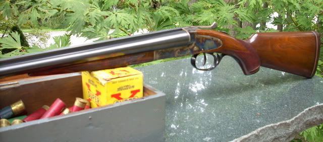

Redone Lefever Nitro Special
By John Gillette
This gun was practically trashed from years of use and abuse. However, it had great sentimental value. Now I don't have to put a bag over it when I take it to the trap range.
Note the lack of the signature "bull's eyes"
seen on the torched guns.
Great-Great Grandson of D.M. Lefever
