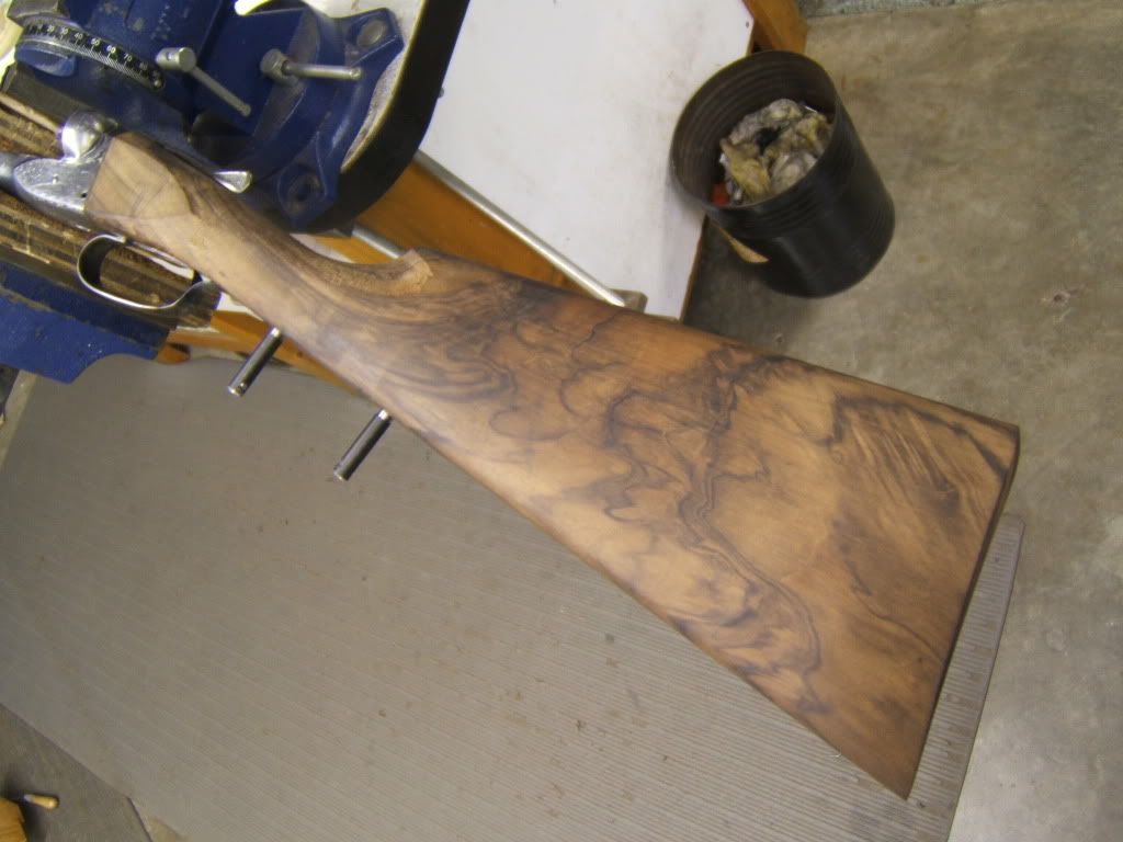

Been working on this one for a bitthere was some brazed extensions on the lower and upper tangs ( crude stock repair) that needed to be removed lots of metalwork around the trigger guard..dents all over the place, had to make all new screws
still in the shaping stages but what do you think?...too much wood for the BE?

Claudio, don't feel like you are locked into the less than interesting checkering pattern from catalog pictures. I have recently seen B Grades with a bit more artistic checkering patterns that I feel are factory original. Keep looking.

I think the B grade Foxes quite often were stocked in a higher grade of walnut then one would think would be appropriate for that grade of gun. However, your particular piece would perhaps be worthy of a grade D (or higher) Fox. Looks like its slab sawn that then turns into quarter or rift sawn closer to the receiver and I'm guessing that is English Walnut.

Bill, I have been looking but the most interesting pattern Ive seen is the one on Silvers gun I think I will do something along those linesmaybe vary the side panels a bit
Tut Ive seen that gun before I was hoping mine would turn out slightly betterI think the tool was a bit dull when they checkered that one
The blank was one of those that worked out in reverse, it was not as fancy as a slab but the streaks got more elaborate as I whittled it down, cant complain about that, a bit of red colour will tone down the contrast somewhat and make it more age appropriate
