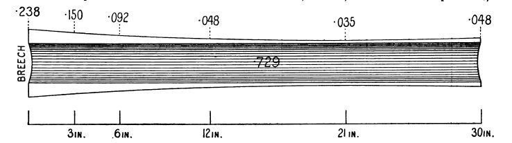

Out of interest,from 1891 so more than likely Damascus barrels?

No Greg; fluid steel barrels including Whitworth and Siemens were part of the 1891 Birmingham Proof House Trial

Yes,I was just pointing out that these thicknesses would have been considered fairly normal for Damascus or steel barrels at the time?
I expect nowadays modern barrels would possibly be thinner at the breech due to stronger steels.

Greg, I've seen that photo before and I think it is of great help. Since it doesn't provide a measurement at 8", and since that is a common measurement area, would it be reasonable to estimate that it would be .070" at 9" from Breech? And .081 at 7.5" from the Breech? Thus, at 8.25" from Breech it would be
.075"? I could extrapolate what 8" would be with a spreadsheet ASSUMING that loss of metal to the walls is consistent in the gaps on the drawing above.
I've heard before that you want to be at .045" to .050" at 8" from the breech but I could never identify the reference that drew that conclusion, I merely am repeating folklore.
