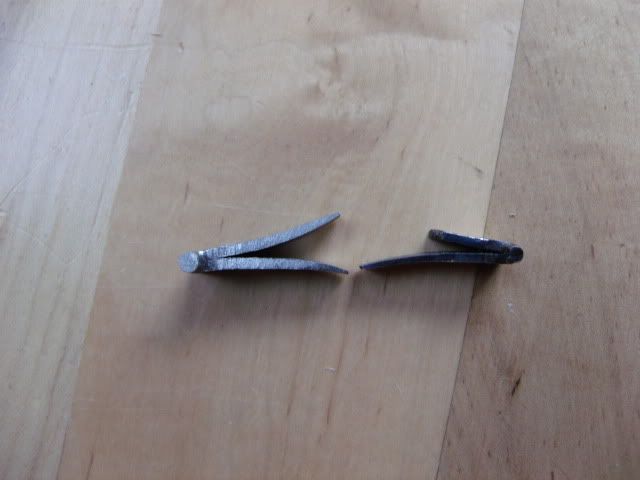

I just finished the shaping and it is ready for hardening. The book was key.
Getting there:
That's more like it:

Awesome! Keep it up...I'm really happy my notes helped.

Thanks again for everything, I wanted to close this by showing I pulled it off. I put this old gun back in action. It isn't much to look at, but is perfect for the chukar slopes.
