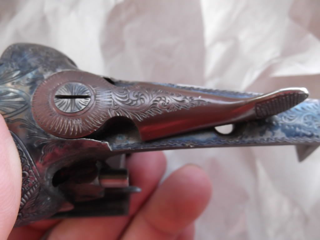

Yes Max the top levers have turned a plum color. I am assuming they would not have come this way? I now have the guns carefully stripped down and the finish off. I will soak them out to assure all of the oil is out. I found several cracks that will need repaired. Steam out a few dents and then finish. along with new pads. I finally took some more pictures, not great but may help to get me additinal information on my guns.
Thanks Phil

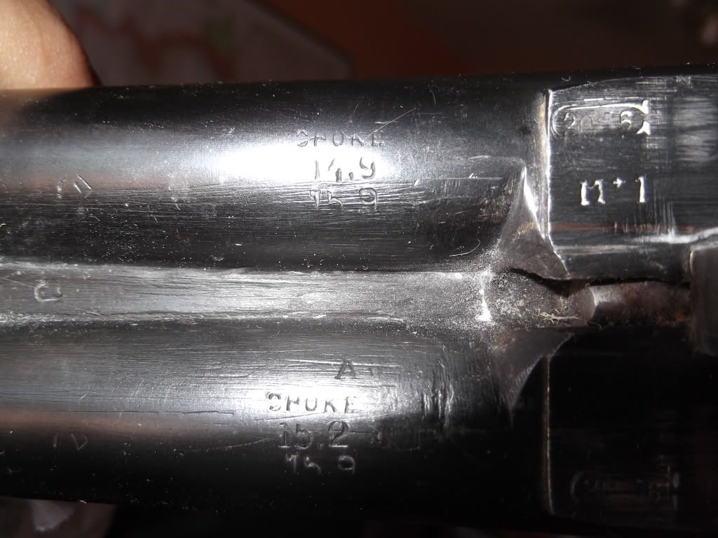

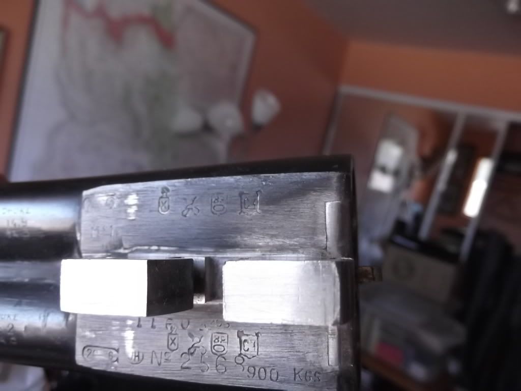

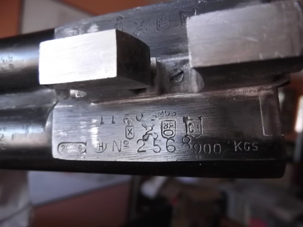

Eibar Proof house, 20 gauge, three inch chambers, proof year code looks like 'M*1' (1967), cannot tell who made the barrels.
Here are a couple of marked up photos with the marking labeled:

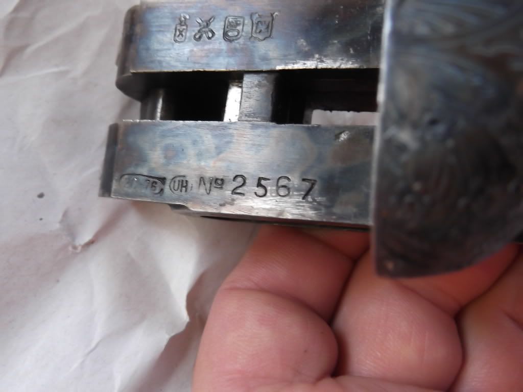

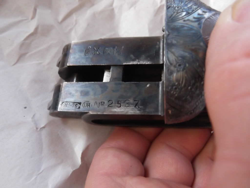

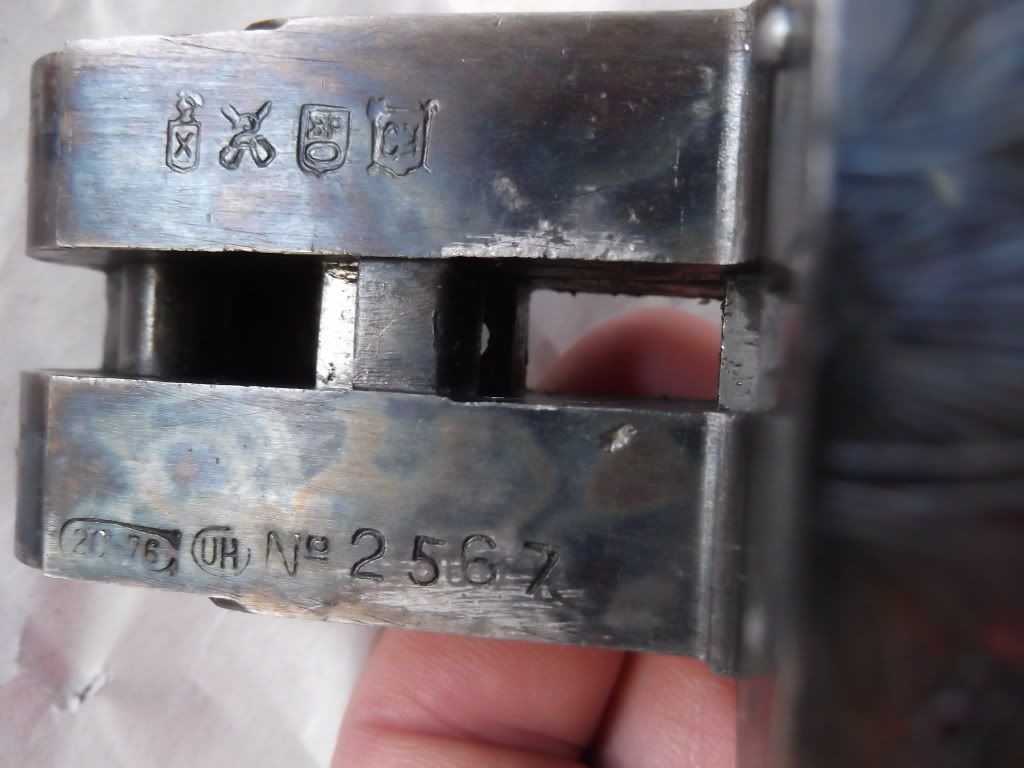

Kyrie,
Thanks for all of the extra effort you went through to identify the markings on the barrel flats and water table. Can you explain, I am not sure what 12 70 stnds for since it is a 20 gauge. Thanks again.
Phil
Joined: Jul 2008
Posts: 1,008
Joined: Jul 2008
Posts: 1,008
Phillip- I think Kyrie used his gun as an example. If you look at the marks on yours, you will see "20 76" which means 20 ga, 76mm shell (nominally 3-inch)
On Kyrie's gun it reads "12 70" which means 12 ga, 70mm or nominally 2 3/4-inch chamber.
