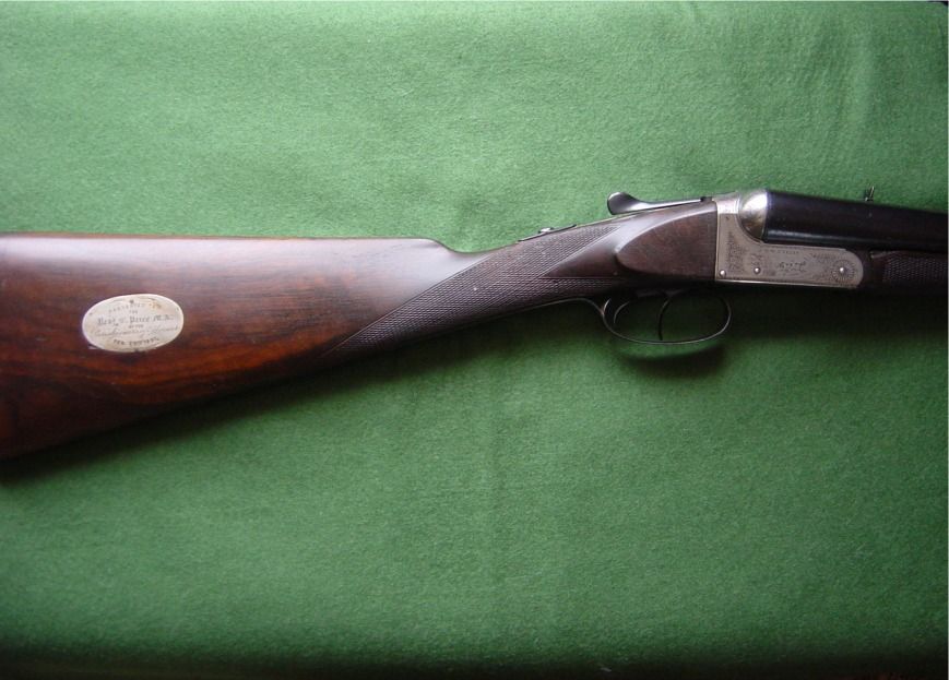

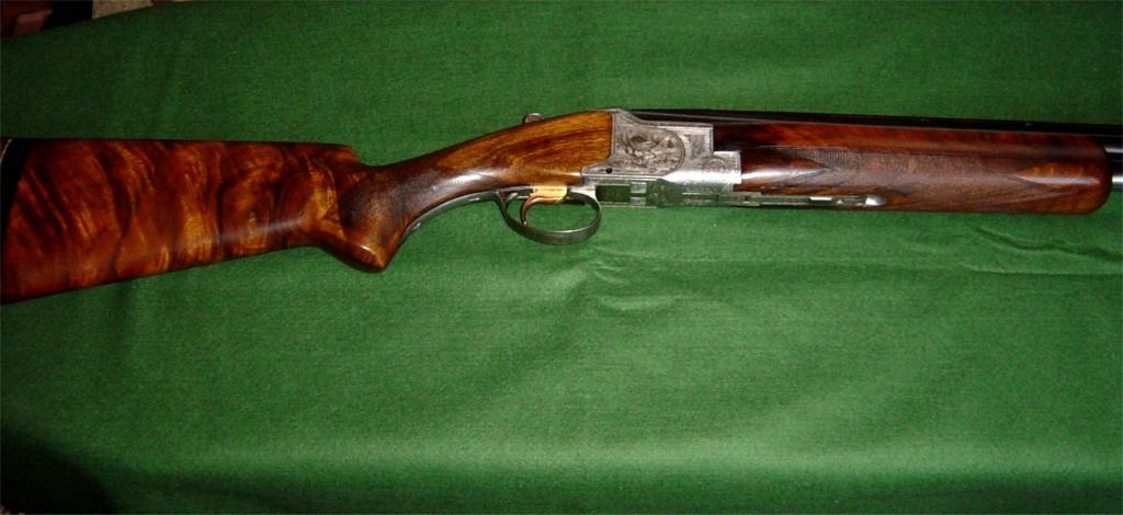

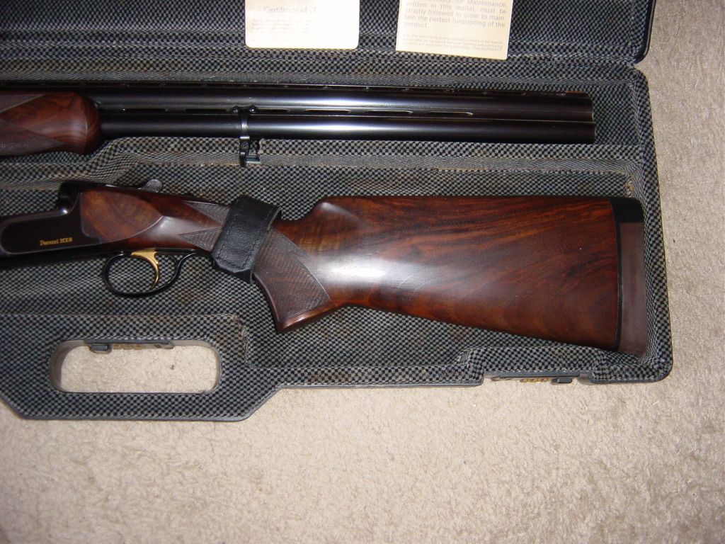

I try to show some pictures of a few gunstocks I did in this way over the years.
The camera Flash shows the wood to be much shinier than it actually is!!
