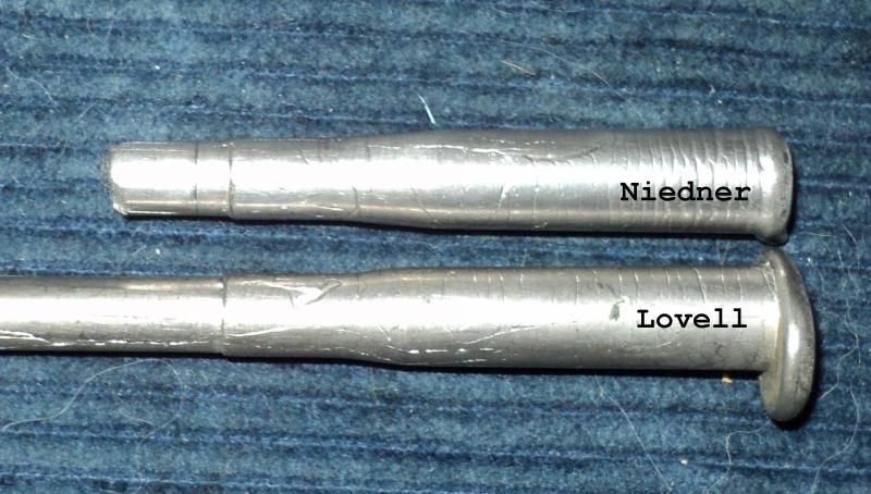

It's unusual to find an original Lovell, most were R-2 or converted to R-2 or Maxim. My G&H is a Lovell as well but the brass for it will not chamber in the Niedner. The Niedner has a much tighter chamber and I'll have to do a little work to get stuff to fit.

The rifle is a lot like a .22-Lovell but it's not anywhere near the drawings I have of one. I ran up to John's he has a .22-Lovell and chamber cast and we compared them. Not the best picture but you can see the difference.
