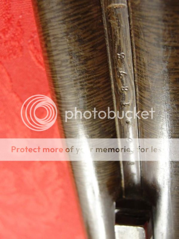

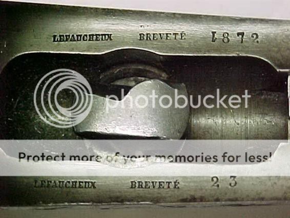

Hello All,
Buckstix and I might have bored the whole board to death with our Lefaucheux rifle adventures, but something is puzzling me.
When looking at my 1898 rifle, there is a 5 digit number on the bottom rib with a specific font. Often this is followed by a date.
I assumed until now that it was a Lefaucheux number, and then I realized that I had seen similar numbers before on other guns with Bernard barrels.
I have seen this on "no brand" guns, Guyot, Chapu, Lepage and Lefaucheux...
the dates are:
Devisme #3583 : 1843
No pic
Perrin #8184 : 1854
No Pic
Lepage-Moutier
#6084 : 1850
#17078: 18??
Lefaucheux described here
#19526 : 1866
#20938:1868
No name lever action
#23177 : 1870
Faure Lepage #24759:1873
Guyot #30685 : 1882
Roblin #33??? : A
The first A I know of. The number looks like 33169.
Guyot #357xx : ????
Pigeon #37xxx : post 1899
Gastine Rennette #38083: post 1899
So now the issue is that:
- The only obvious common element is the barrel maker (Bernard)
- A barrel maker is not usually providing the ribs, and even less assembled tubes
So either:
- Bernard was actually providing the assembled gun to all these guys
- somebody else was and from 1850 to 1900s! I sure don't know who that could be...
If you guys have Bernard barrels from any maker please look for this numbering and report, that would be fantastic!
Good hunt,
WC-
P.S> US Parkers don't seem to have this...

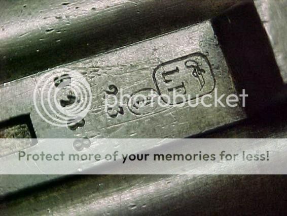

Just curious here- what are the scratched marks on the right tube flat on the Gaston Renette set of barrels?

The scratch marks are a full set of reinforced Paris proof circa 1900+.
provisional (EP), PT 70mm, and finals proof (the ships).
The ships are the banner of Paris which motto is "fluctuat nec mergitur" "it floats but does not sink", which refers ro the origin of Paris on an island on the Seine river.

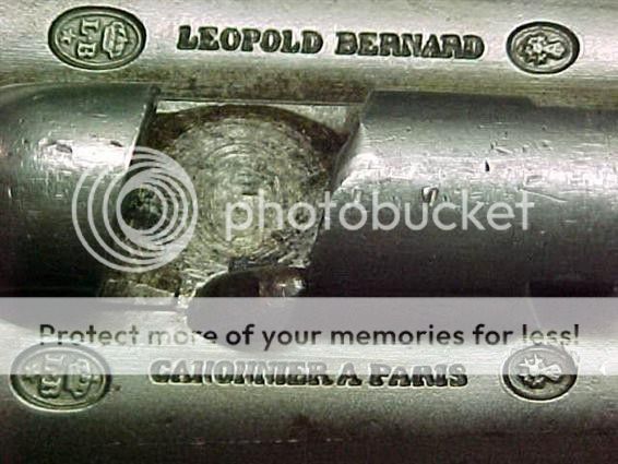

Well I get that, but the stamps fonts are identical all the way from the 1850s to 1900, and the numbers are sequential, which would pretty much rule this out.
It is true that Bernard stamps were imitated by a host of others.
His "brand" was very valuable, and therefore imitated. I also have to believe that the "E. Bernard" maker from Liege was benefiting from the name similarity. I have yet to see an L. Bernard gun. I have only seen barrels.
One also can see that his original stamps were just (LB) and Leopold Bernard. Down the road, the legion of honor stamp showed up (he probably got it) and the "Canonnier a Paris" as well.

Have P Mullin 10 ga M/L With BERNARD LEOPOLD on underside of right BBL
and CANNNONIER PARIS on left BBL. 12377 1859 Pictures too follow soon
reguards
Bill McPhail

Not a very good picture, but one can see the 5 digit code, although there is no date stamped onto the barrels, as is seen on some of the other examples. I have no idea if these are "Bernard" or not. The barrel is off a Guyot.
Cameron Hughes
Posts: 12,076
Likes: 377
Posts: 12,076
Likes: 377
Those are London proofed tubes.

Thanks to Mr. Hallquist for brining my attention to the following 1869 Leopold Bernard tubeset:
Lefaucheux Brevet - 1872
22369.1869 - given by retailer
Posts: 12,076
Likes: 377
Posts: 12,076
Likes: 377

Posts: 534
Posts: 534
Hi Sam,
Congratulations on your project. One has to be commanded to even attempt such a rescue.
It turns out that the overwhelming majority (read all) of US guns with barrels described as "Bernard" were not made by Leopold Bernard. One could order "Bernard" style barrels from the Belgian trade and that's where all those barrels came from. Your Sauer is similar, I am certain.
LB had a touchmark that he used from the 1840s until the end of the company in the early 1900s. Those barrels also had the serial number and date or date code on the lower rib.That is well documented in previous threads. If yours does not have it, by definition it is not a true Bernard.
LB was an ultra-premium barrel maker for most of his carrier including after his death in the 1870s. Barrel sets produced were very few for many decades of production. I think annual production was around 500 per year.
Many barrel makers copied the style of his touch mark including an E. Bernard from Belgium, who produced tons of fake L Bernards.
It does not really matter anyhow. Enjoy your Sauer for what it is!

Anyone know what datastring is on the lower rib of the Bernard tubeset on Matska Nr. 17 - 1882(on water-table)(MAUKA - F. MACKA) -
30465 - 1882???

Léopold Bernard Nr. 29906 - 1881 - worn by Guyot hammergun.

Yeah, with the name Léopold Bernard involved / associated with the metal, Fantastic Metal is a given.

Is that C. Lefaucheux's trademark on the fore lug?
Hochachtungsvoll,
Posts: 12,076
Likes: 377
Posts: 12,076
Likes: 377
Something akin to this??? Well, there it is a couple post previous.....
