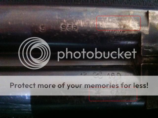

Raimey, OK, here are two more pics forward and to the rear of the flats (behind the lug). To the best of my knowledge, these are the remaining markings on the gun.

The gun was given to me by my father -in-law (born in 1927) now with Alzheimers. It was owned by his father who, to the best of my knowledge did not participate in WW I but had owned it prior to his son's birth. This supports the 1923 date but doesn't explain where it came from.

I think it is a little earlier, possibly circa WWI? I think a tube maker's mark or maker's mark can be found in the red enclosed area. Looks like CA? Regardless, it was made in Liege more than likely by a smaller concern considering the serial number. I don't see the weight of the tubeset anywhere?

Raimey, It's definitely a "CA", is the 958 the serial no? How do you know it was made in Liege?

Looks like there may be another letter after the CA? All the proofmarks are from the Liege facility and it was not very economical to make it elsewhere and then have it proofed in Liege. The mechanics embraced mechanization early on and there was virtually no one in the world that could compete with them on price. I would say the 952 is the serial number and not an assembly number, but the possibility exists.

I missed the very first post that said "Chevalier" "A Paris" (left barrel).
Well, that does it as far as location.
It turns out that when E. Lefaucheux closed down in 1881, he was succeeded by "Chevalier et Dru". Apparently Chevalier closed down in 1889.
That seems quite ancient for a Greener bolted boxlock, but that would explain the lack of barrel weight.
On the other hand the 16 C in a rhombus appeared in 1898. So I am still confused....
